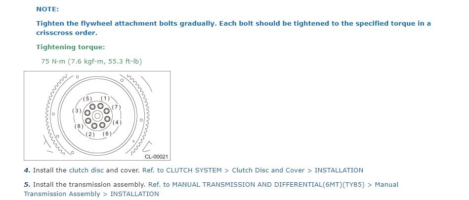

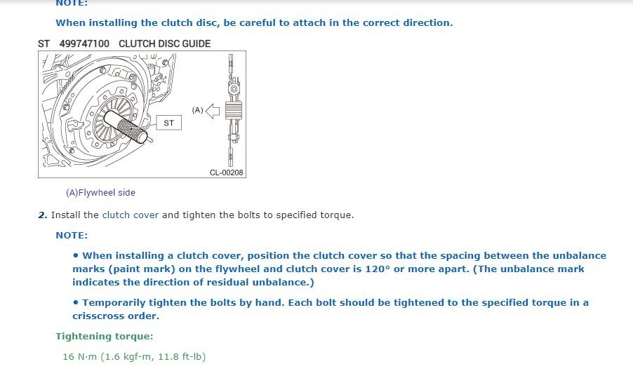

This is a WRX with the 2.0T...Torquing flywheel to engine, pressure plate to flywheel specs please.
Also, would you grease the throw out bearing or just where the transmission goes into the engine?
Thicker part of the clutch with the springs is towards me when installing it on top of the flywheel correct?

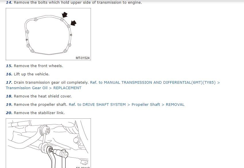

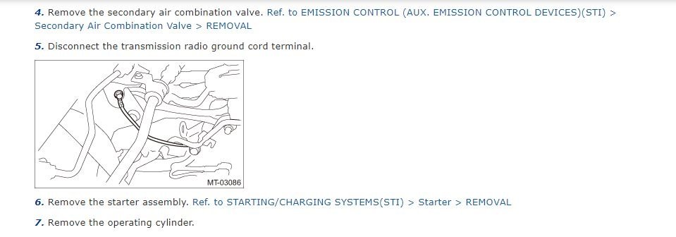

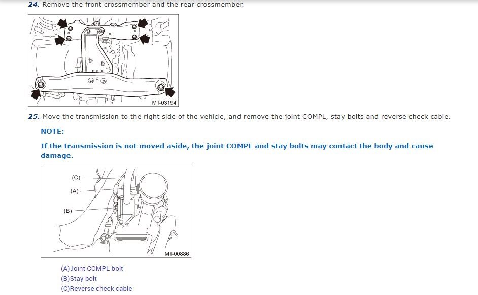

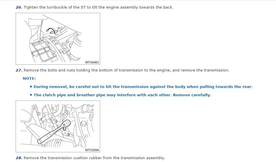

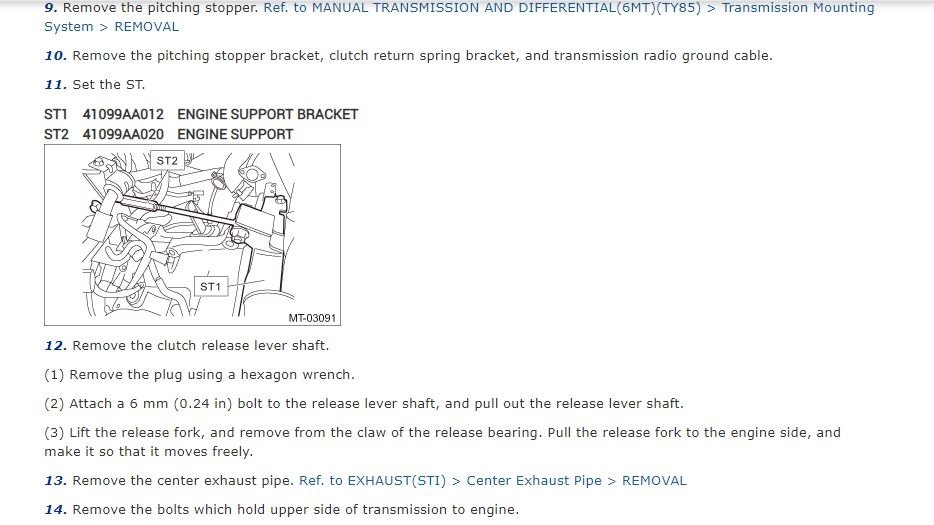

Good evening,
I attached the specs for you below for the torque of the pressure plate and the flywheel. The bolt sequence is there as well.
Let me know if you have any other questions.

2 videos showing it at 26 ft/lbs for the pressure plate and another for 12 ft/lbs and a forum stating it should be at 26 ft/lbs.
not sure why.
Sep 15, 2021 at 5:07 PM
This information came right from Alldata. I double-checked again and it is correct.
Sep 15, 2021 at 5:10 PM

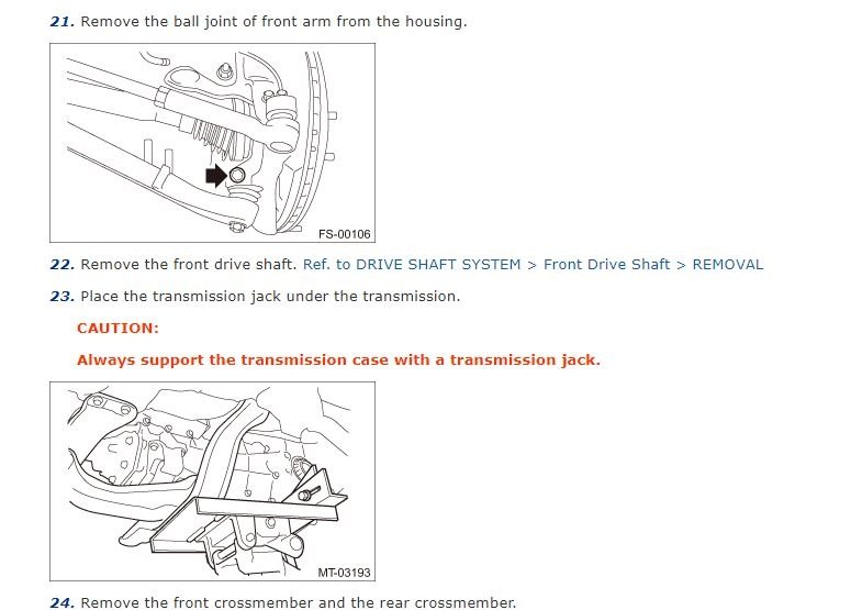

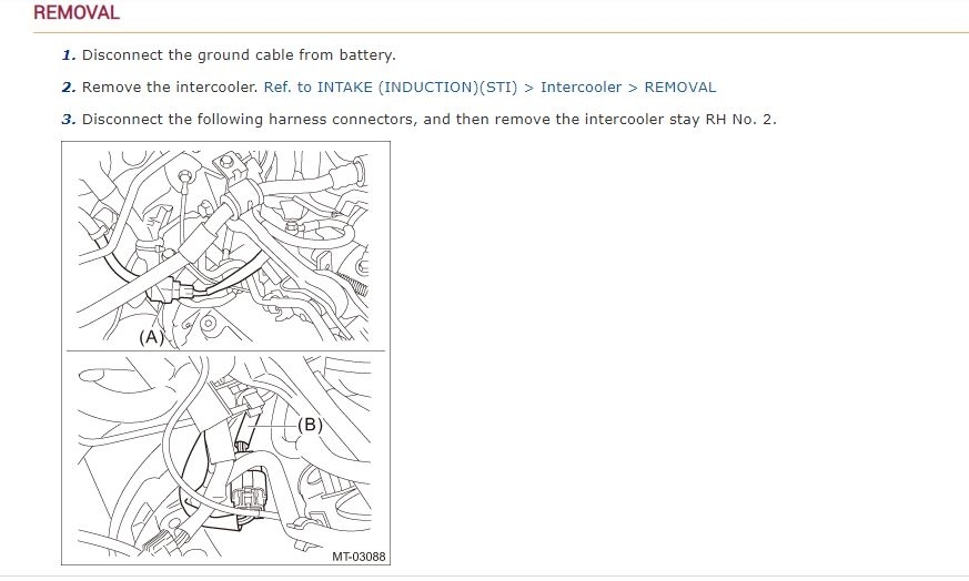

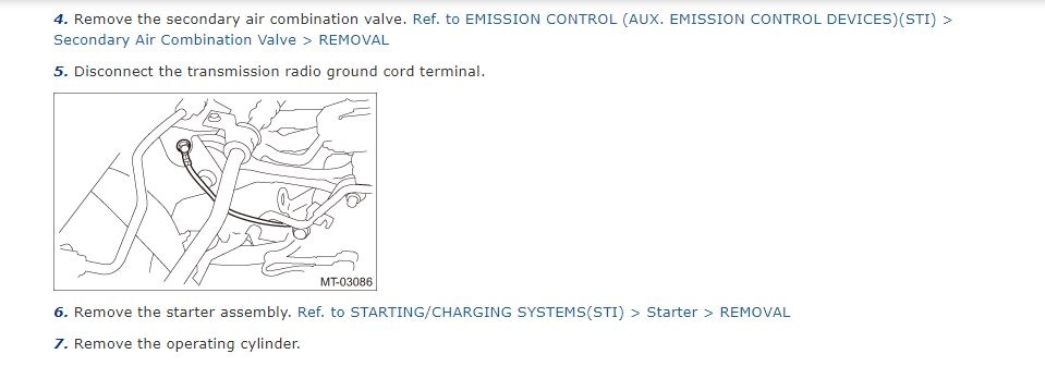

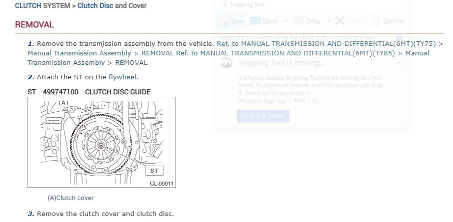

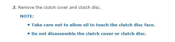

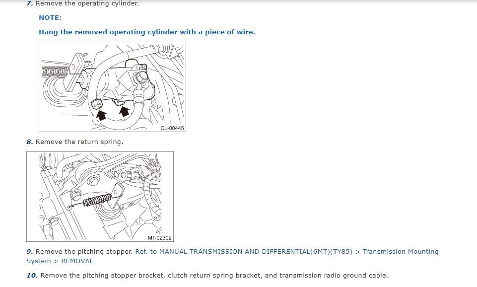

I also attached the procedure for the clutch assembly below.
