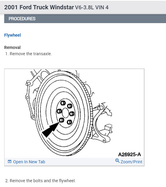

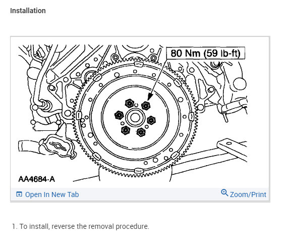

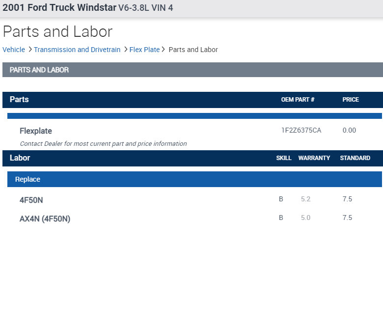

On this Windstar 3.8L, the flywheel/flex plate OEM part number is 1F2Z6375CA.
This part was used in 2001 and 2002 Windstar's.
