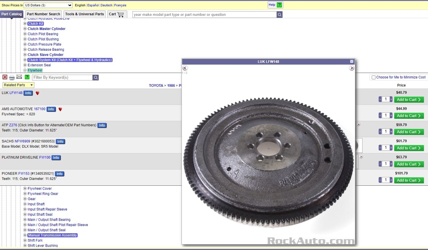

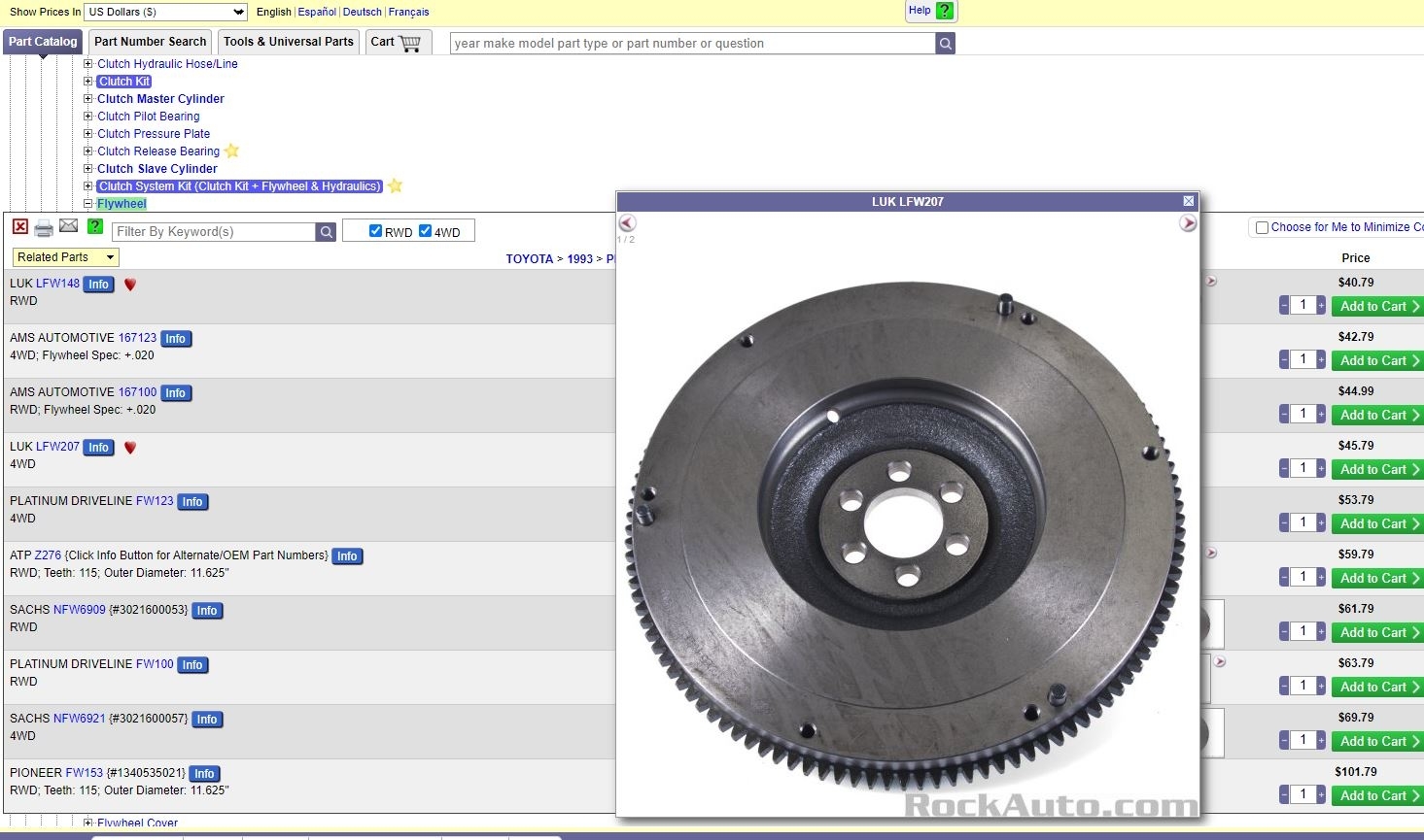

Hello again,
Which flywheel did you use for the swap? Was the donor motor a 4 wheel drive?
There is a difference in the flywheel from the 2 to 4 wheel drive.

The guy who owned the truck thinks it may be a 2wd he doesn't remember, he said they had to match a 1983 clutch to a 1983 flywheel and put it on a 1993 4x4 Toyota pickup. How can I tell the difference? He says he doesn't see why they are different in flywheels.
Apr 2, 2021 at 9:31 AM
Do you have the old flywheel from the failed engine?
I posted pictures of the flywheels in a previous post. They are definitely different.
