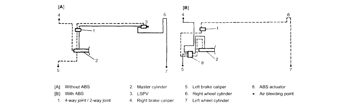

Where is bleeder valve on rear drums? looked at right rear passenger and only saw two lines going into drum. how do i change fluid for all tires? I have ABS so do i have an LSPV? if so how does that play into things? and is it a dual master with front lines and back separate? thanks.

Bleeder screws are normally located on the wheel cylinder when drum brakes are used and on disc on the caliper. What are you referring to by LSPV? Air bleeding is necessary at right and left front wheel brakes, left rear wheel brake and LSPV (if equipped without ABS), ie., four places (three places for vehicle with ABS) in all. So, with LSPV bleed at the left rear wheel cylinder and that LSPV, then the two fronts. Look at this diagram showing both.
