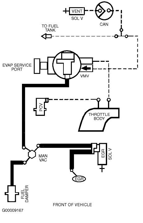

if the line was bad the egr passage could be partially blocked or all together. scan for codes and check fuel pressure with a gauge auto parts rent it. when you go for testing, change oil and filter, drive 20 miles on eway if you can then get it tested. I'm sending correct vauum routing. also check for a vacuum leak like canister purge solenoid
