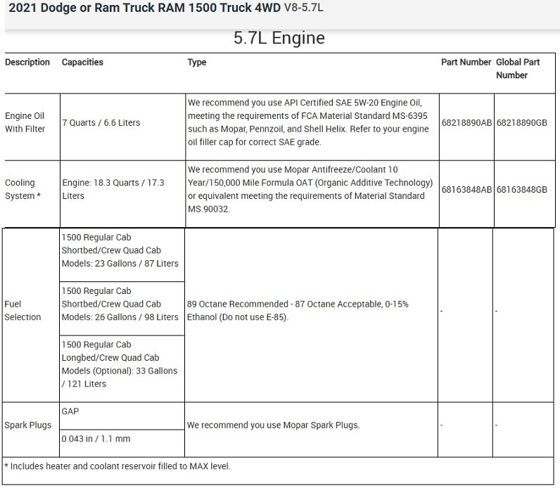

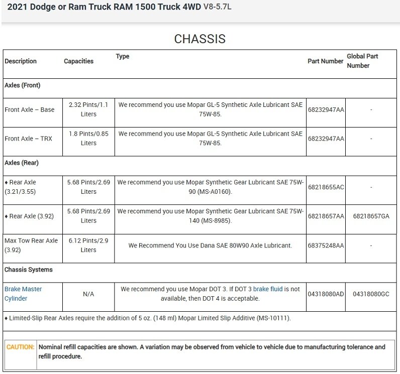

If your truck is a 1500, it has a rack and pinion steering gear with electric power assist. You'll see there is no belt-driven power steering pump on the front of the engine. This doesn't even show up in the specifications. I posted some fluid charts but they don't include the recommended change intervals.
