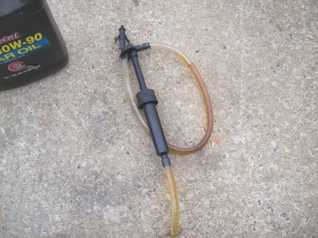

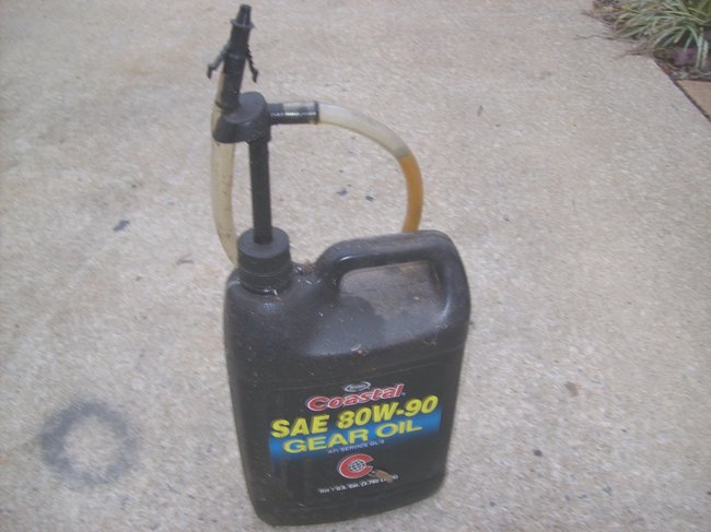

Pouring this stuff from whatever container you get into a cleaned out gallon antifreeze jug and then purchasing a cheap pump from an auto parts store (maybe $7.00) will let you fill up without making a mess!

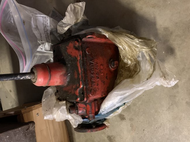

Hi, someone sent me a photo of the Bantam Transmission, by this photo can you tell how and where to add the gear oil.
Thank you, Kenny

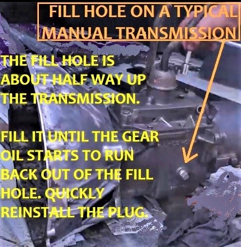

I made you a pic in "MS Paint". See pic below.
Does this make it better to understand?
The fill plug on any manual transmission might be on either side, about halfway up.
Most also have a drain plug either way down low on a side or down on the bottom side. Some even have a magnet made into the drain plug to catch any wear metal shavings so they don't circulate in the transmission.

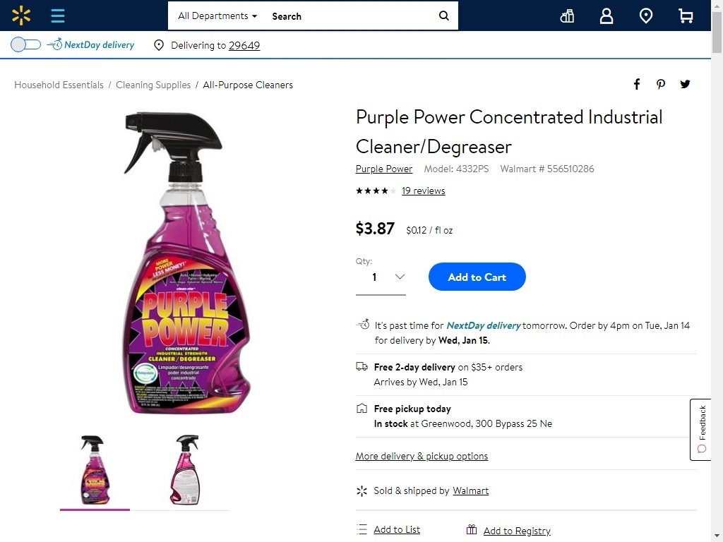

Purple power (sometimes with a little brushing) and a garden hose sprayer will clean that grease off fast and easy and make it look really good! The ole time regular kind works just fine too.

Mr. Medic, hi, the transmission photo is not from my car, mine is still in my car.
If possible can you take a look at the picture I sent you?
The confusion for me is, if you look at the left side of the photo, there is a large top screw - bolt which may be where the fluid goes in, otherwise what is this top bolt for.
The side bolt maybe where the fluid flows out when it's full.
Please take a second look.
Thank you, Kenny

Gearboxes (transmissions) are not filled up nearer to the top due to fluid expansion and possibly "bogging" the gear movement down. The fluid gets slung by the gears to where it needs to go.
The fill for the rear probably works the same way, around halfway up will be the fill plug.
