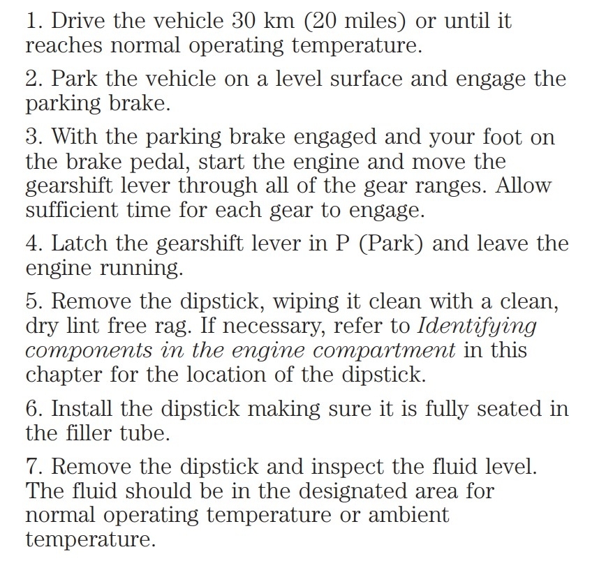

Yes, can you tell me how to check the level of the transmission fluid possible a video if possible. thank you.

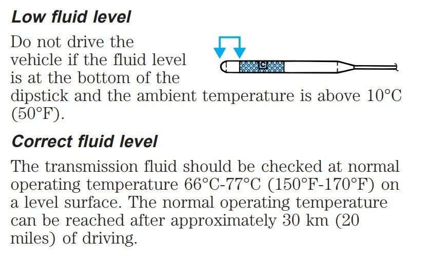

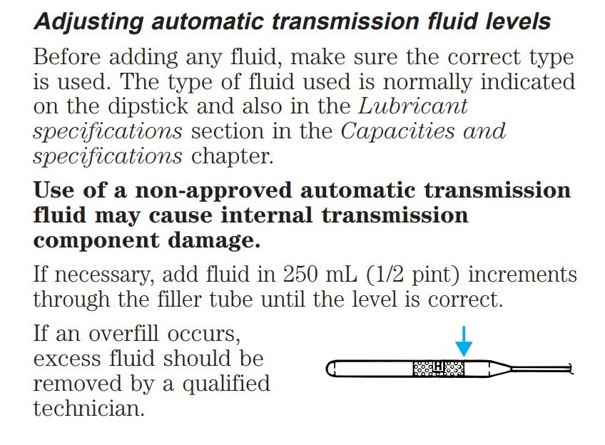

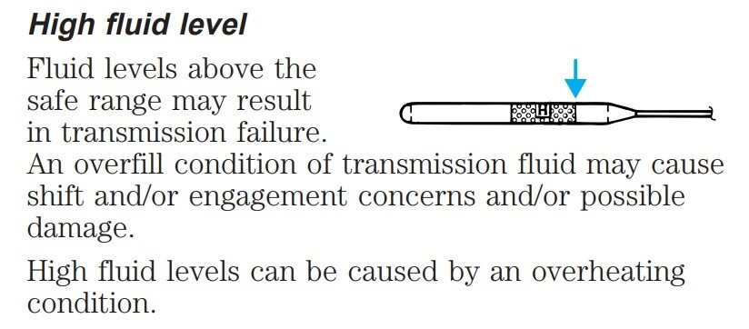

Attached you will find the section of the owner's manual that covers the fluid checks on that car. It uses Mercon V fluid. If the mileage you posted is correct you have a record holding car.
This guide may also help:
https://www.2carpros.com/articles/how-to-check-and-add-transmission-fluid
