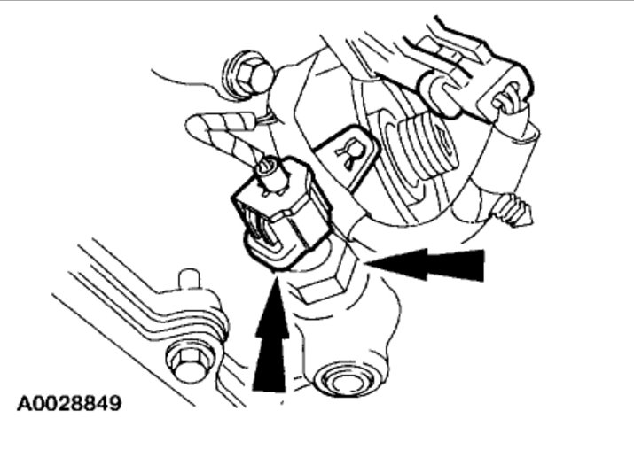

When I turn the car on the oil pressure gauge acts normally, but if I have been running it for a while, and I pull up to a stoplight, or have to idle for any period of time while in drive and not neutral, my oil pressure gauge will fluctuate slightly. It does not drop the whole way up and down, it just shimmies and shakes This is new for my car and I am wondering if it is a problem foretelling bad stuff down the road or just an older car with over 200,000 miles on it showing wear and tear? Thanks in advance for letting me know what might be wrong guys.
Aug 16, 2017 at 8:17 PM
I would start by changing the oil and the oil pressure sensor. Here is a guide to help you with that and I diagram (below) to show you where the sensor is which is down by the oil filter:

Upon further inspection I believe the problem is electrical in nature, though I am not certain what makes it happen. the problem gets worse if I am using one or more of my electrical devices (ie radio AC defrost).
Aug 17, 2017 at 3:26 PM
This can be caused by an alternator that is failing by leaking AC voltage into the system. Here is a guide that will help you confirm the problem.
Please let us know what you find.
