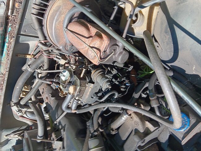

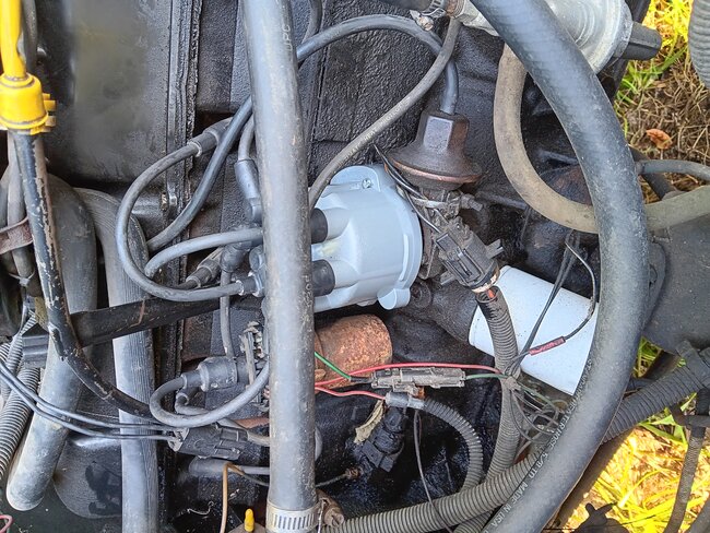

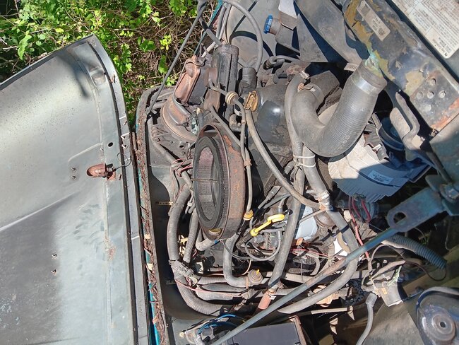

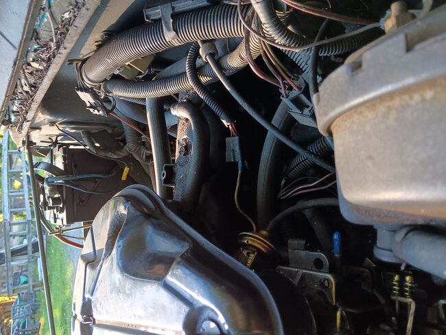

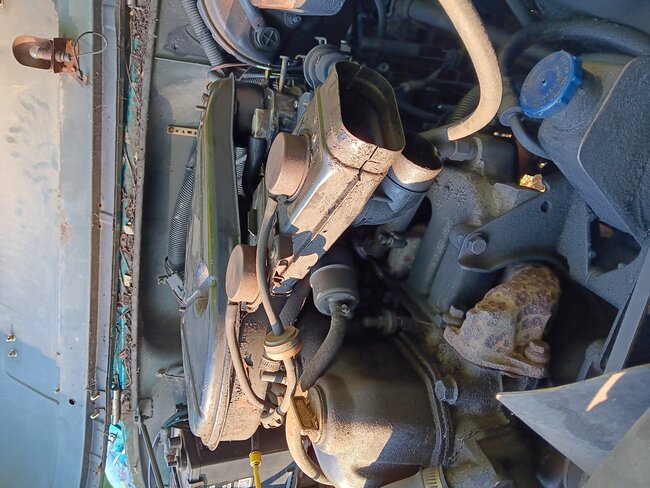

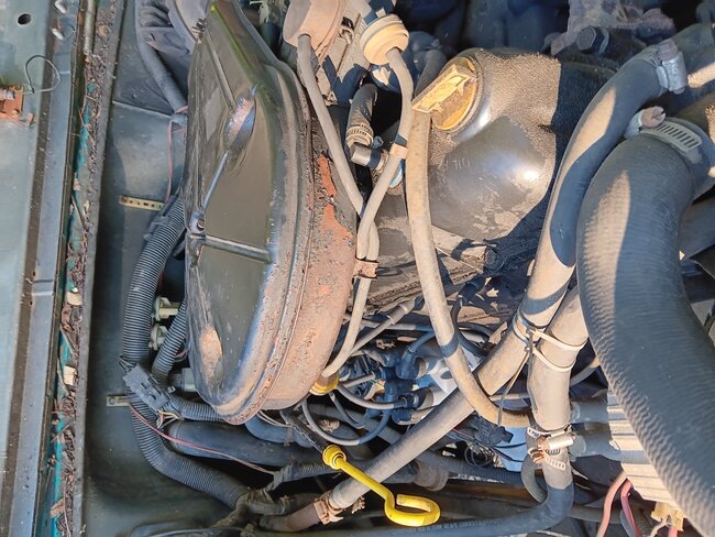

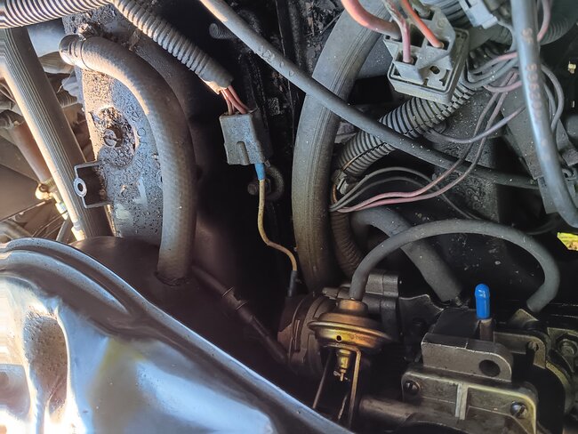

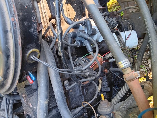

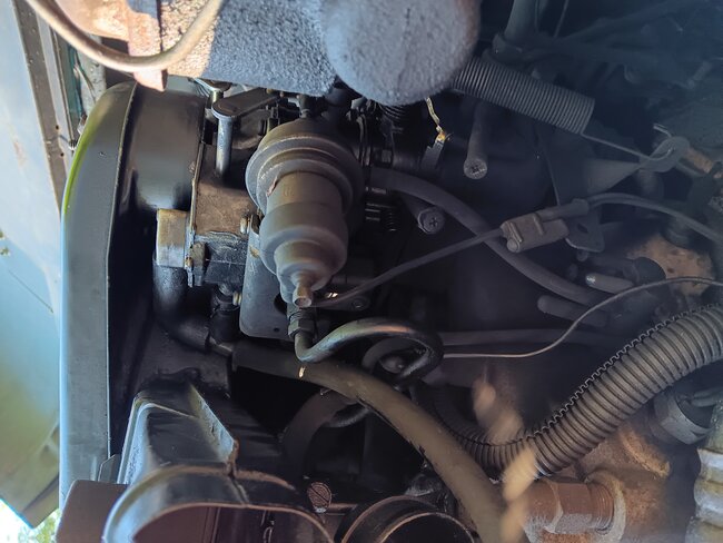

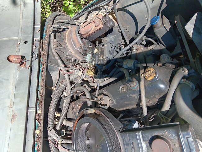

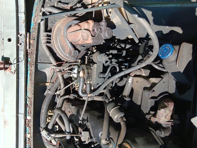

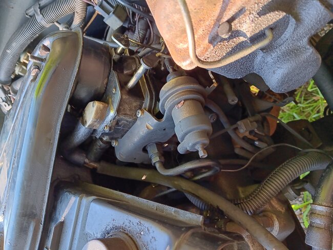

Here's the photos:
Sep 1, 2023 at 1:02 PM

Maybe some more closer (not too close) pics around the
carburetor, intake manifold
(vacuum lines)
and maybe some around the distributor.
Do you have tools/ meters/ etc that you can use to correctly tune
your Jeep? Timing light/ dwell-tach/ vacuum gauge?
Do you know how to use them?

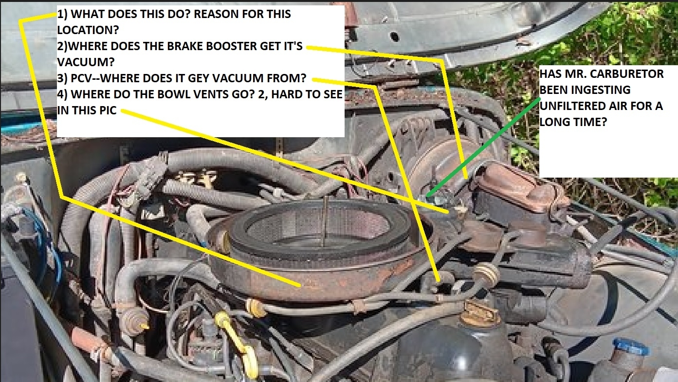

I have a couple of pics for you.
----The Medic

CJ MEDEVAC
  • 11,004 POSTS
All rightey!
I have to explain this like this unless you have magical powers!
I don't know if it's actually flooding or not (yes, it is possible
your needle and seat may be allowing too much fuel in, either
set wrong, or defective parts (bad needle and seat/ float with a
hole in it).
I usually save that stuff for last.
It may have a choke setting problem.
Nevertheless, Things must be set the best they can be to
make it want to run. Like correct adjustments and such.
It's not gonna want to run with it initially being cold.
You will not be able to adjust it wonderfully until it can
stumble it's way on up to operating temperature.
Then it can be adjusted!
Hopefully, no one has abused things like over tightening the
mix screws.
Neglected maintenance parts like spark plugs/ plug wires/
distributor cap/ etc. should be installed. Slinging in
unnecessary stuff in should be avoided.
A real biggie---don't start slinging in a bunch of fad crap
that your buddies recommend!
This exponentially compounds problems!
To do this correctly, you will need some meters/ gauges---it
is impossible to close enough by "ear". (this ain't a push
mower)
I answered a post in 2010 to aid a Jeep guy with his 304.
I used my 258 to talk him through getting his 304 to run.
There may be other things that might need to be addressed
in the thread,
If you'll concentrate on the 258 pics and text, this might
get it running better, then we might tweak things from there.
https://www.2carpros.com/questions/jeep-cj7-1985-jeep-cj7-stalls-when-hot
I had not been a member long back then, my grammar lacks at
times,
I use country boy lingo, and I had a different user name (it was
suggested that I change it) Years later, it's "locked" and
I cannot edit it.
"Vapor Lock" is a real thing, but if your fuel system is still using a
return line to the tank (3 port fuel filter)--it is doubtful you have
that issue at all!
Usually ignorant folks sling that term out there to make
themselves seem knowledgeable!
The tuning stuff you need can come from Amazon/
Yard Sales/ my favorite---Pawn shops (cheap) folks don't
even know what they are!
Let's see if my link helps! Report back with good news!
