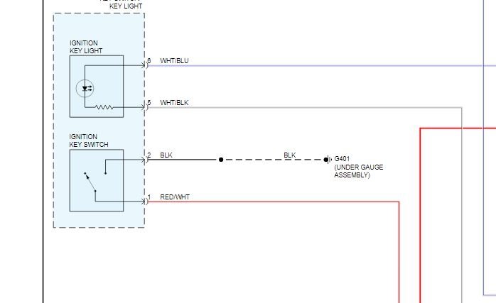

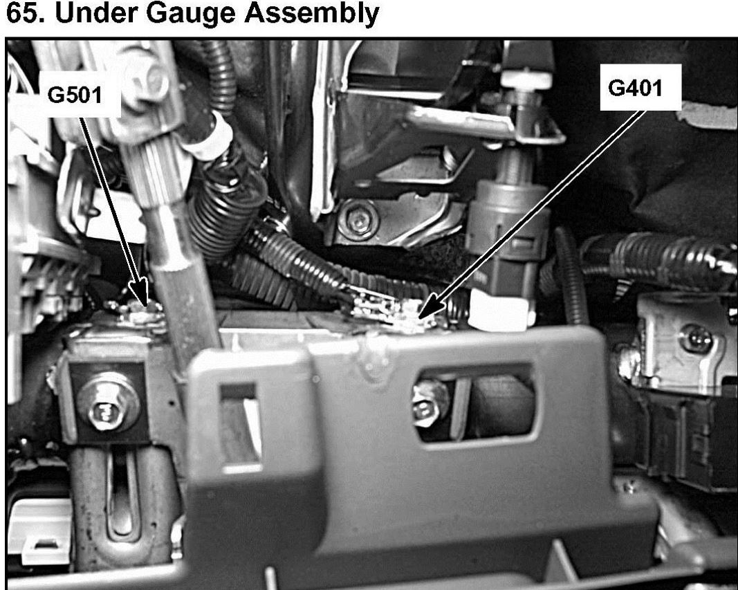

Flickering like that is commonly caused by a loose or corroded connection to the affected circuit. The flicker is the result of the difference in the resistance in the connection. Likely the vibration of the engine coupled with the voltage spiking at the connection cleared the issue. It could return at any time however. The hard part is to find the connection that is at fault. In this case I would look at the ground #401. It grounds the light switch and the interior lights If it were getting bad it could cause flickering as it would be turning the lights on/off. I would also check the battery connections at both ends and the grounds at the engine as those could also cause it and not effect the engine because they were not lasting long enough.
The ground I am referring to is under the dash near the lower area below the steering column.
