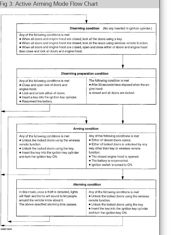

There are 4 conditions in this system which are disarming condition, disarming preparation condition, arming condition and alarming condition.
Disarming condition:
When a user is near the vehicle.
When the alarming function does not operate.
When the theft deterrent function does not operate.
Disarming preparation condition:
Time from a user locks a door to be leaves the vehicle.
Time until transferring to the disarming condition.
Arming condition:
When a user leaves the vehicle completely.
When the theft deterrent function operates.

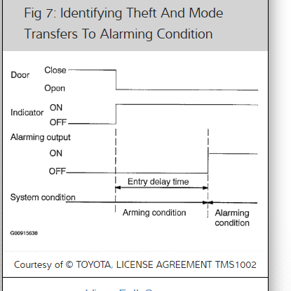

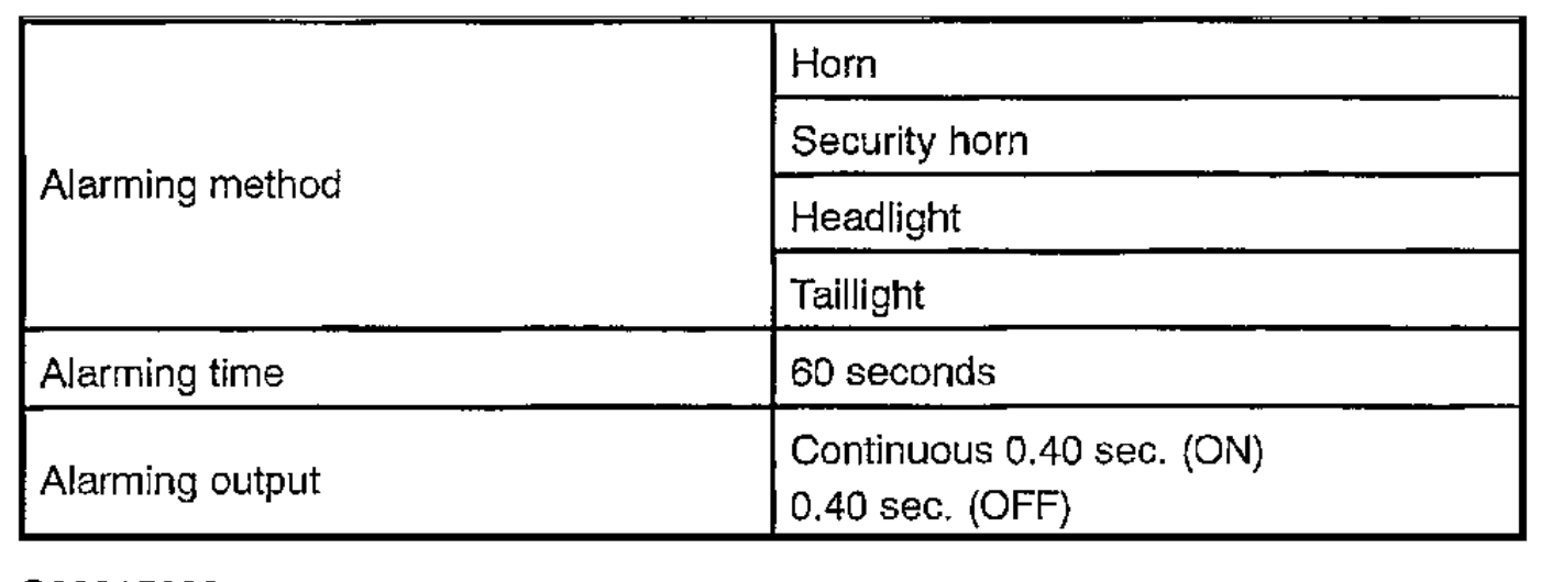

Alarming condition:
In this condition, once a theft is detected, lights will flash and horns will sound to let people around the vehicle know about the theft.
Refer to Fig 2 for alarming method or time.
Fig 2: Alarming Method Or Time Table

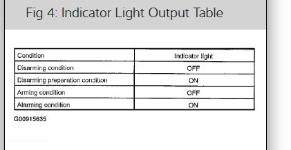

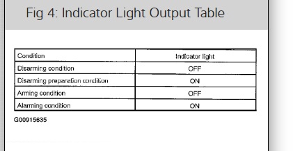

HINT:
In the arming condition, when either of doors is unlocked and no key is in the key cylinder, force lock signal is output.
HINT:
Even in the disarming condition, the indicator light flashes (due to a signal output from immobilizer system). The indicator always flashes by receiving a signal from the immobilizer system at any time in the arming condition.

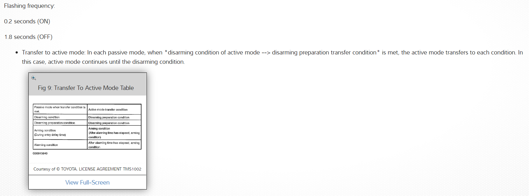

Flashing frequency:
0.2 seconds (ON)
1.8 seconds (OFF)

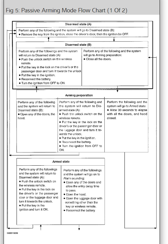

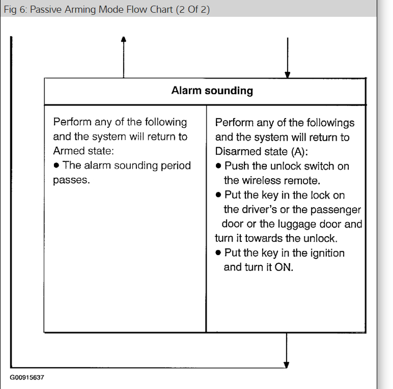

PASSIVE ARMING MODE
This mode can be switched by the specified operation.
All initially set modes (when shipped from factory) are active mode. (No passive mode)
Check out the diagrams (Below). Please let us know what happens.
