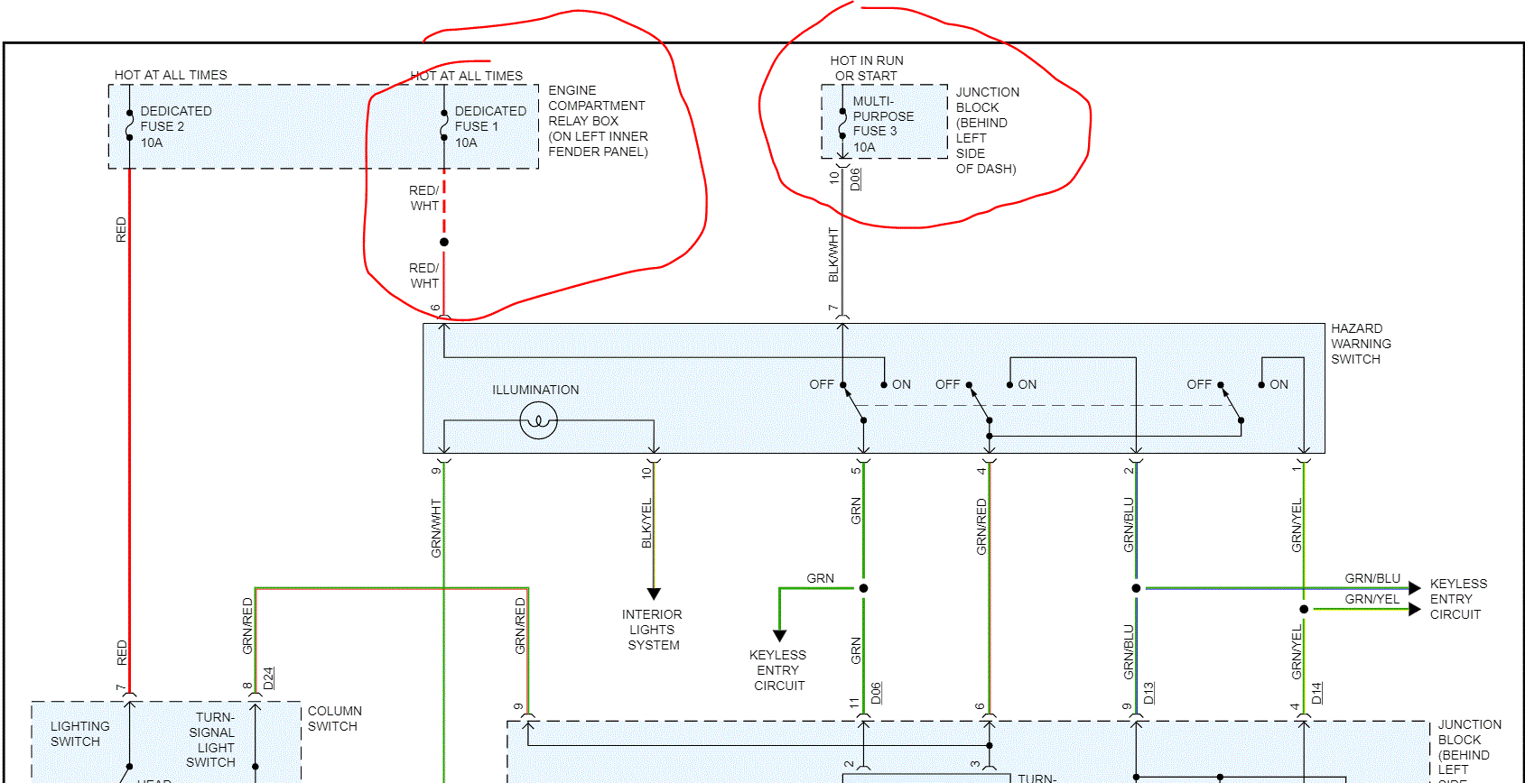

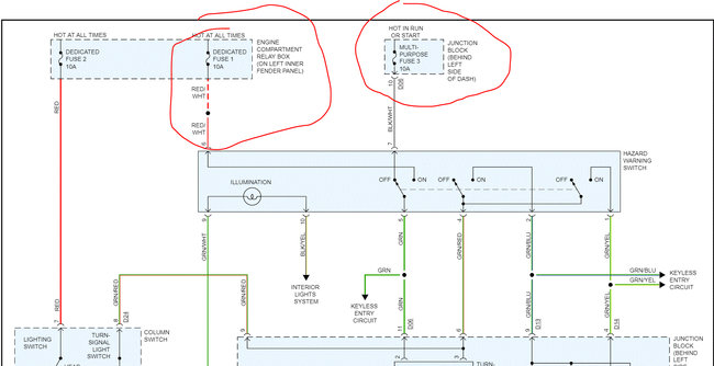

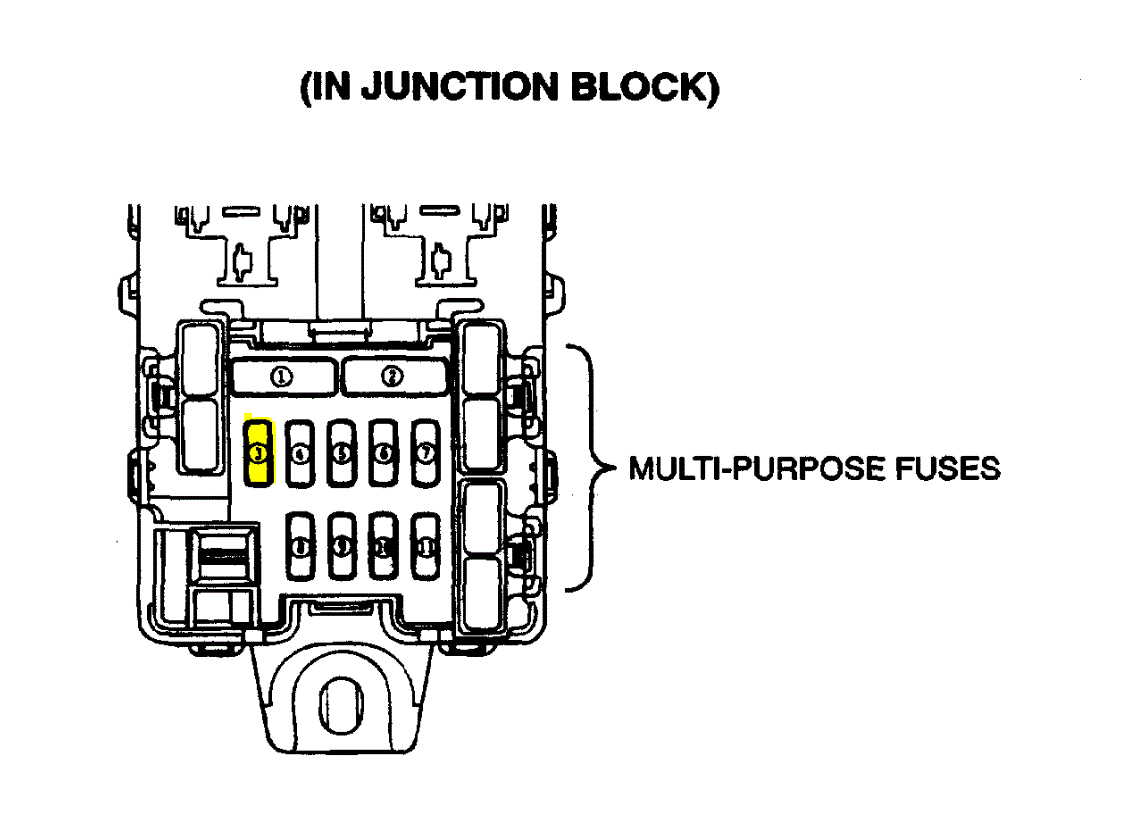

I was wiring up trailer lights to this truck and when I was done I had no turn signals to the to the truck. replace the flasher unit under the dash and had no results same thing. flashers hazard work and turn signals don't. I'm curious because there was nothing turned onto the switch for the blinkers was never turned on. curious what to look for next if it was a fuse wouldn't fuse keep the flashers from working as well?
