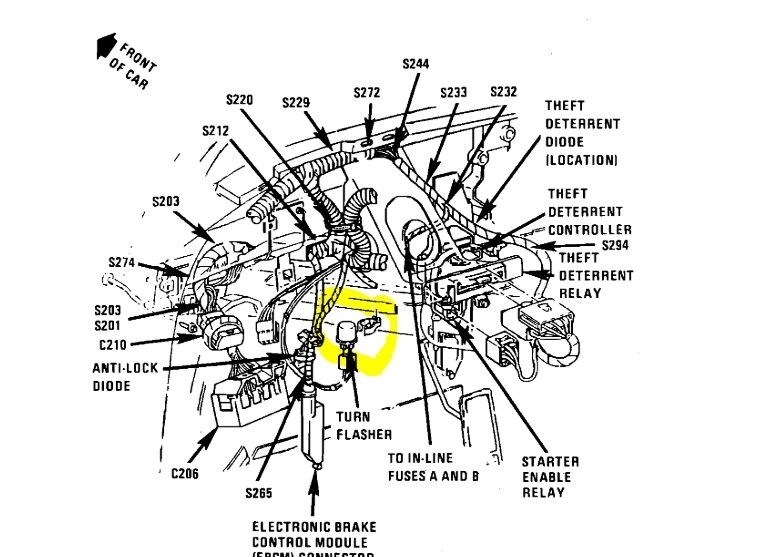

Would you be able help me in locating exactly where my flasher is? I’ve tried the fuse box and underneath the steering column.
Mar 22, 2019 at 1:33 PM
I circled its location in the picture I sent you in the beginning.
Turn on the side that works and feel around for the clicking.
