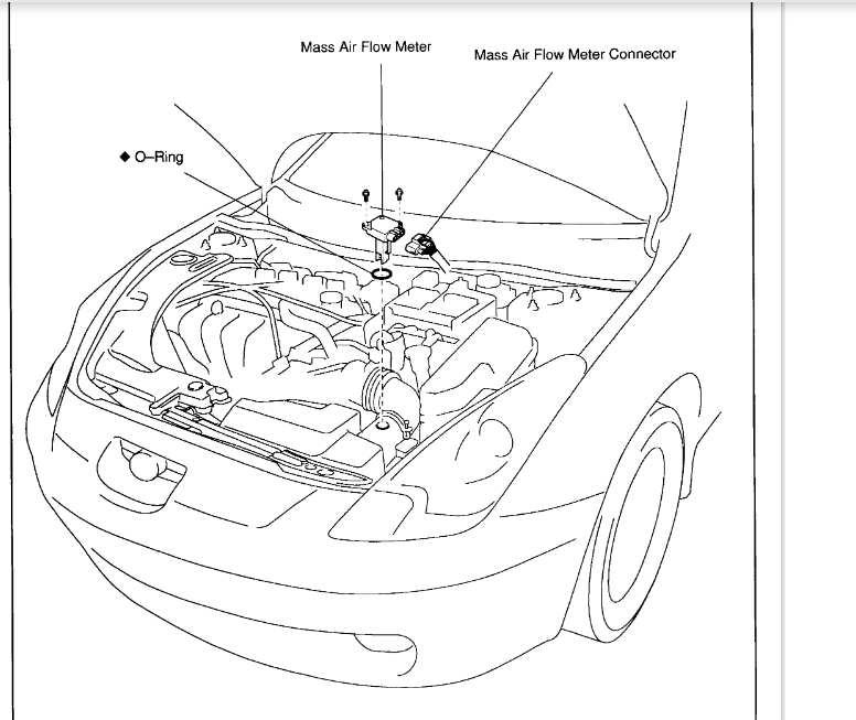

Cleaned MAF sensor (it was really dirty, there was been a K&N air filter used in the car before, thinking some oil of that got on).

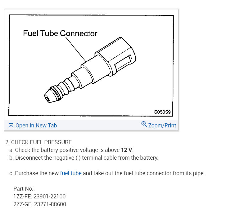

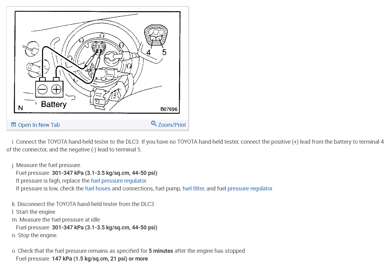

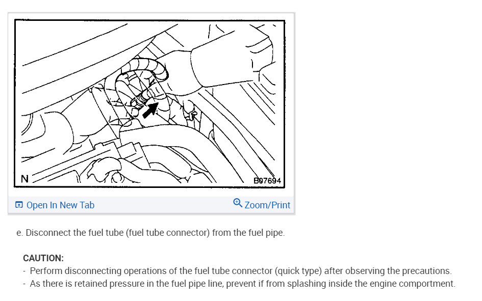

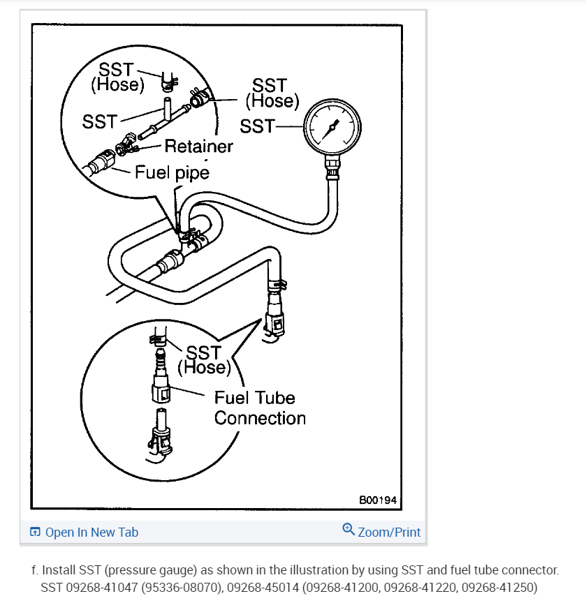

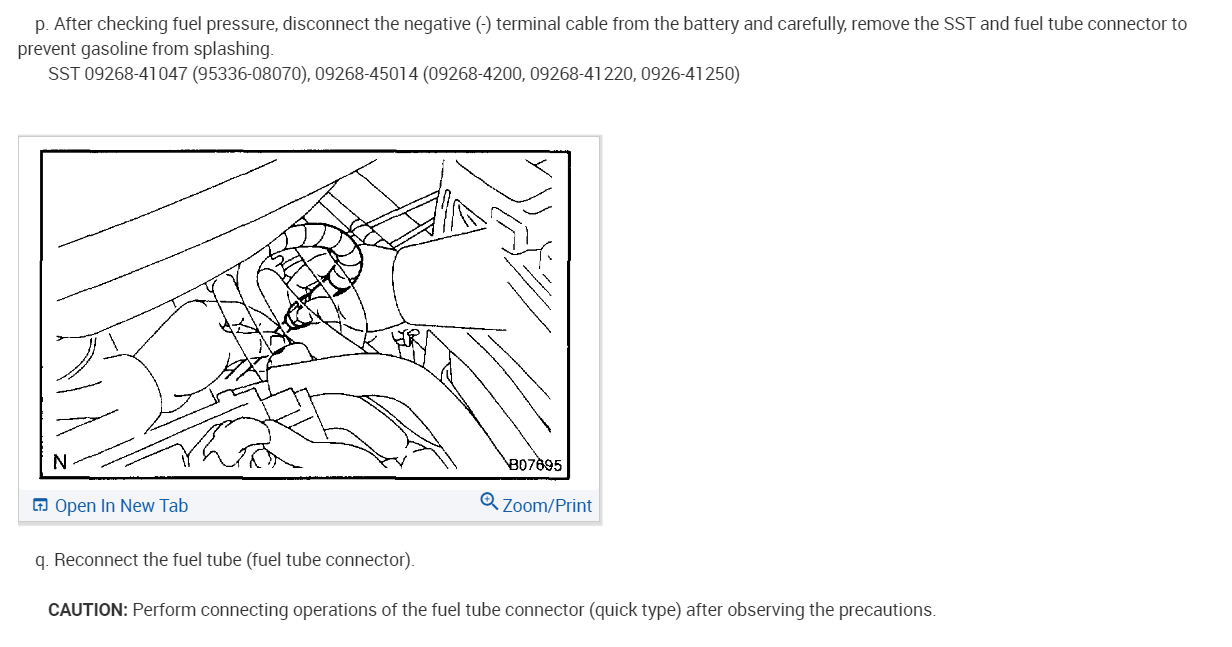

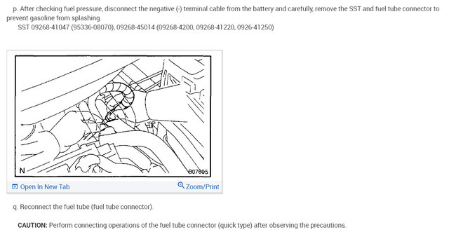

I bought a fuel pressure gauge set to test the pressure, after some research I know how to do it and what to look for, but my main question is where do I connect the gauge to my car, I know I need a fuel pressure line or such, could you please point out where it is located? maybe with a picture or diagram.
