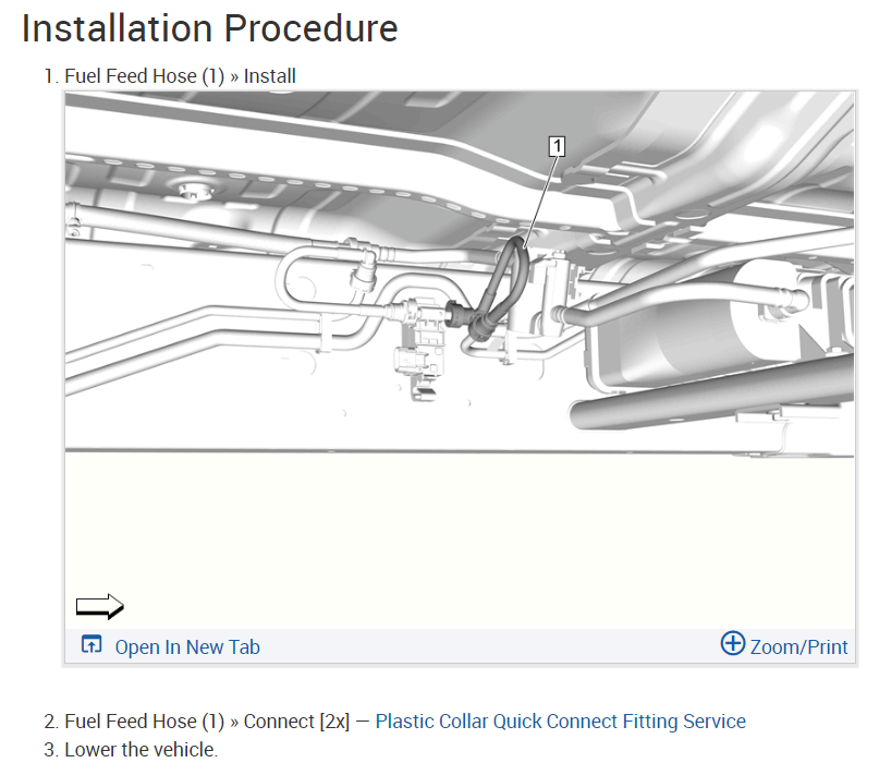

So, an extra fuel filter can cause issues because the fuel system is highly tuned, and it might start to throw codes. You will just have to try it and see. There is no documentation on doing such a thing so I am interested to know if it will work. I have included a possible location for the new fuel filter. Check out the images (below). Please let us know what happens.

I think I will try fitting the filter in the spot that you suggested and will refrain from cutting any original hoses and just make some hoses that fit in between and see how it goes.
