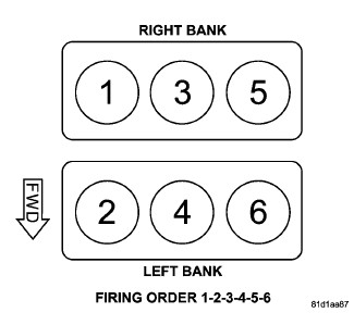

The code read p301 misfire one ignition coil and plugs. so I just need to know the firing order for my vehicle. please help.
Mar 18, 2018 at 11:07 AM
WRENCHTECH
CERTIFIED EXPERT
20,761 POSTS
Here is your firing order. Check out the diagrams (Below). Please let us know if you need anything else to get the problem fixed.
Image (Click to enlarge)

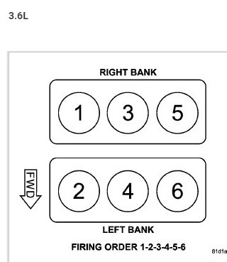

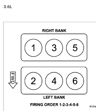

I need to know the order of my coil Packs aka cylinders.
Dec 1, 2020 at 7:51 PM (Merged)
DANNY L
CERTIFIED EXPERT
5,648 POSTS
Hello, I'm Danny.
I've attached the firing order picture below.Hope this helps and thanks for using 2CarPros.
Danny-
