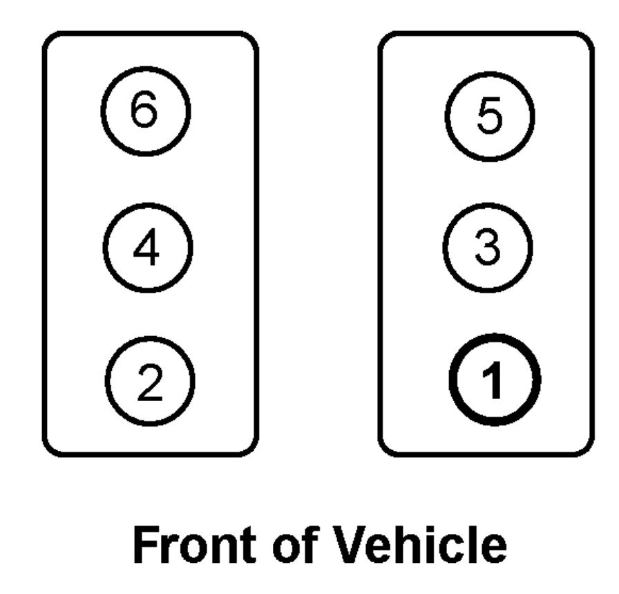

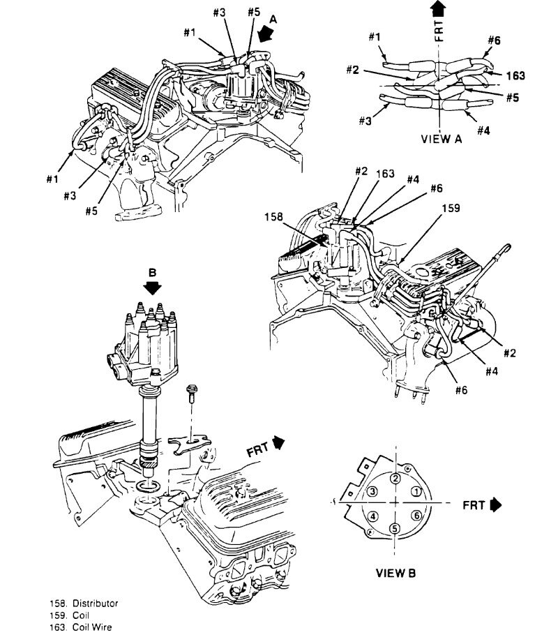

Can I please get a diagram of the firing order for my vehicle listed above?
Sep 15, 2024 at 10:36 PM
STEVE W.
CERTIFIED EXPERT
15,113 POSTS
Firing order on the 4.3 is 1-6-5-4-3-2. The attached shows the cylinder numbers and the plug wire routing for each cylinder.
