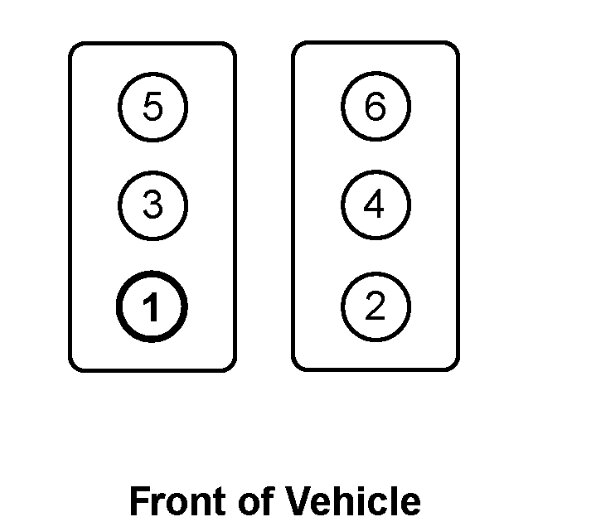

The cylinders are arranged in 2 banks of 3 with a 60-degree included angle. The right bank of cylinders are number 1-3-5 and the left bank of cylinders are 2-4-6, viewed from the flywheel end of the engine. The engine firing order is 1-2-3-4-5-6. (see pic below)

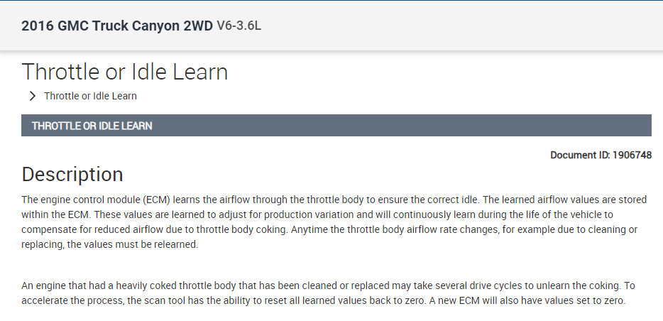

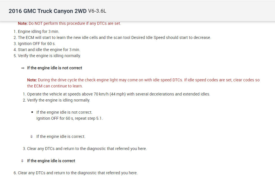

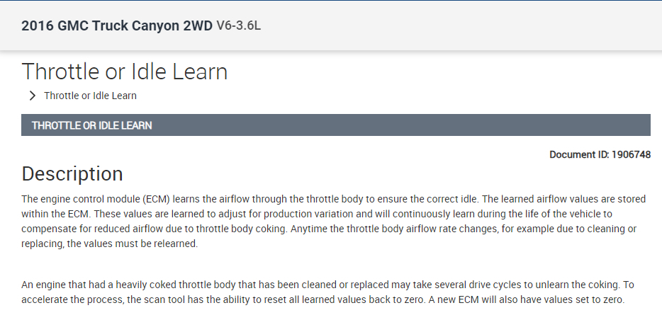

As far as the relearn, the remaining pics explain how that is done.
Take a look through this info and let me know if that is what you need or if you have other questions
