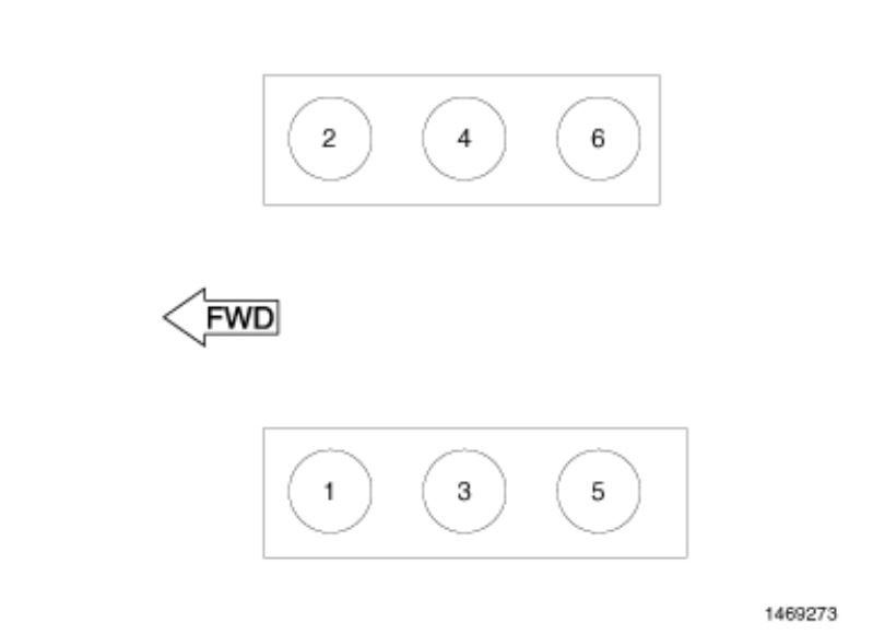

Looking for the coil order/diagram for this truck. took the motor apart now I need this order. Please and thank you!
Feb 12, 2020 at 11:51 AM
Good afternoon,
I attached the firing order and the cylinder location for you. Check out the diagrams (Below). Please let us know if you need anything else to get the problem fixed.
Feb 12, 2020 at 12:36 PM

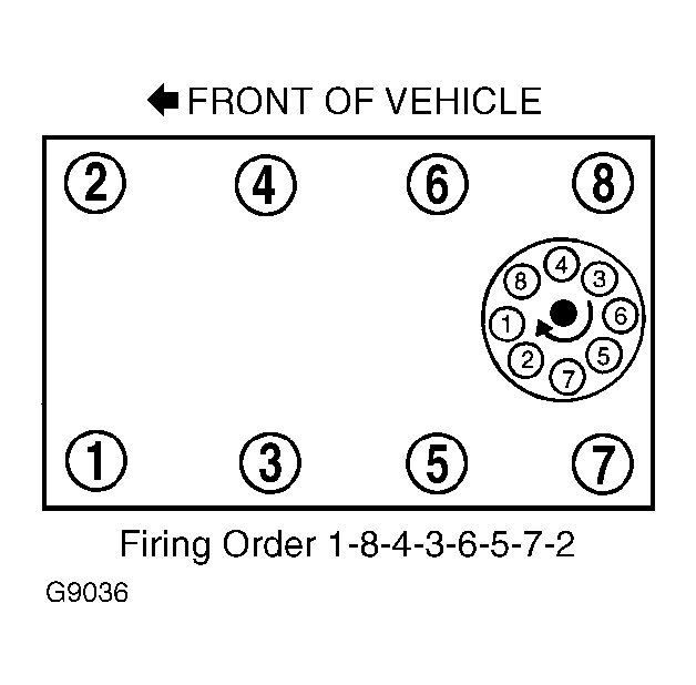

I would like to know what the firing order for this engine. I replaced spark plugs, distributor and rotor and the engine is missing now.
Sep 11, 2020 at 1:48 PM (Merged)
HBAUGH
  • 8 POSTS
The firing order for you car is - 18436572

What is the spark plug firing order for 1987 Dodge van-5.9L? Where is no. 1 on cap?
Sep 11, 2020 at 1:49 PM (Merged)
RASMATAZ
  • 75,992 POSTS
Here you go
https://www.2carpros.com/forum/automotive_pictures/12900_dodge_fo_2.jpg

CARMENJONES
Hi, Went to autozone who told me the #6 spark plug wire may be faulty off the test light. Do you have the location of each of the spark plug? Thanks!
Dec 19, 2020 at 9:57 AM (Merged)
MERLIN2021
  • 17,250 POSTS
This is 5.2 V8 5.9 is the same. Check out the diagrams (Below). Please let us know if you need anything else to get the problem fixed.
https://www.2carpros.com/forum/automotive_pictures/62217_52_firing_Order_1.jpg
