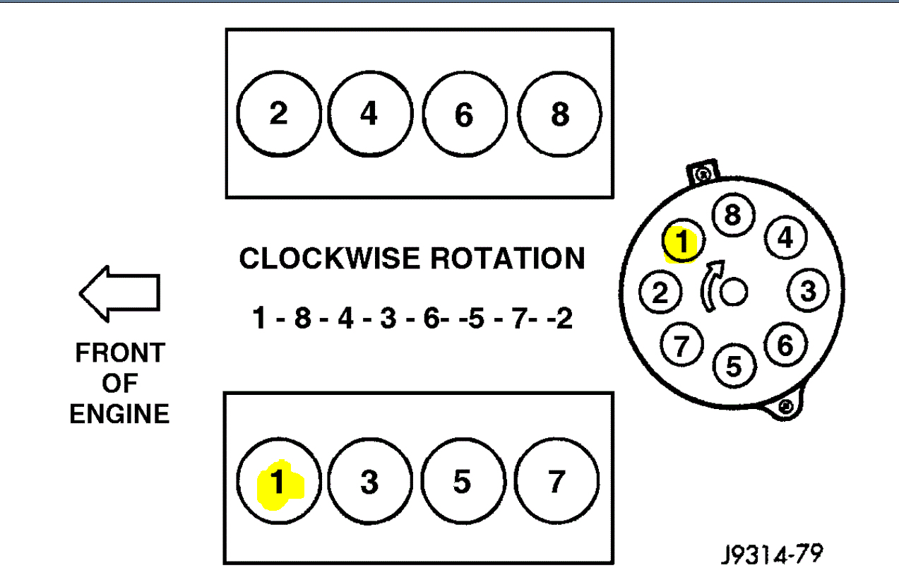

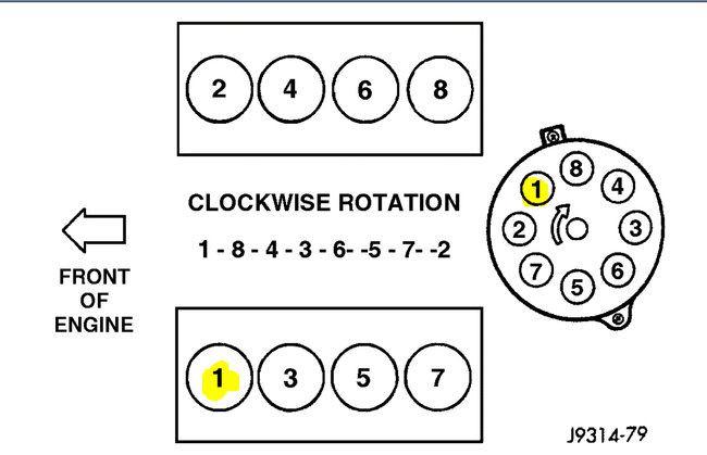

I need a diagram of the plug firing order and a diagram of the wire routing for my vehicle listed above. please
Mar 26, 2022 at 6:05 PM
I attached a picture below of the distributor and the engine cylinders. Simply run the spark plug wires from the distributor cap to the plugs following the numbers indicated.
The firing order is 1 8 4 3 6 5 7 2
Let me know if this is what you need.
See pic below.
