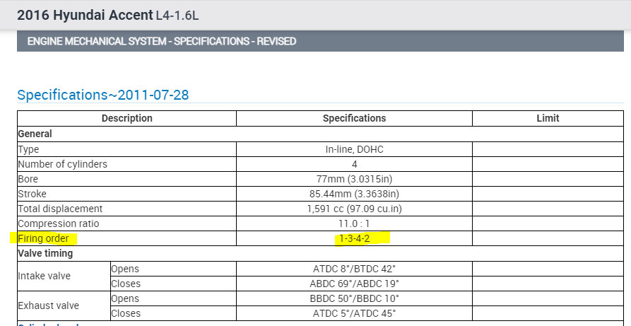

If you look below, I attached the requested info. As far as identifying cylinder location, cylinder one should be at the front of the engine.
See pic below.
