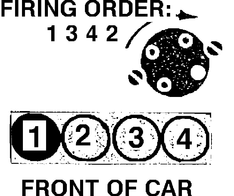

What is the Firing order?
1986 PONTIAC GRAND AM
195,000 MILES • 2.5L • 4 CYL • 2WD • AUTOMATIC
STEVE4545
MEMBER
1 POST
FOLLOW
And what direction does the distributor rotate? Thanks
Dec 8, 2022 at 2:23 PM
CARADIODOC
CERTIFIED EXPERT
34,306 POSTS
Distributor rotates clockwise. Check out the images (below). Let us know if you need anything else.
Image (Click to enlarge)
Dec 8, 2022 at 4:10 PM
