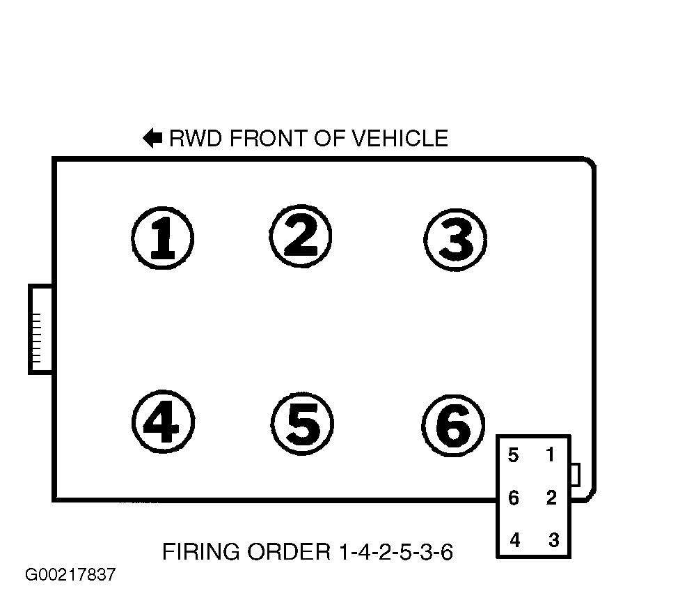

I need firing order for the SUV listed above.

There are two versions, VIN E and VIN X. This diagram is for VIN E. The only difference for the other one is the location of the ignition coil pack.
