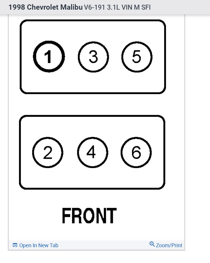

I'm looking for the firing order for my car listed above ltz.
Sep 15, 2019 at 11:05 AM
CERTIFIED EXPERT
52,796 POSTS
Good afternoon,
I attached the firing order for you. Check out the diagrams (Below). Please let us know if you need anything else to get the problem fixed.
Image (Click to enlarge)

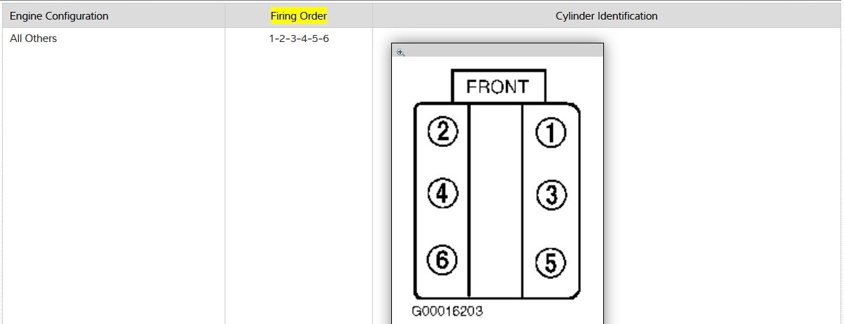

HARRY P
CERTIFIED EXPERT
2,292 POSTS
Here it is.

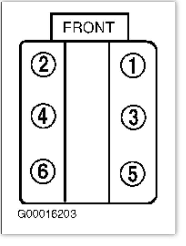

WRENCHTECH
CERTIFIED EXPERT
20,761 POSTS
I believe this is what you are probably looking for.

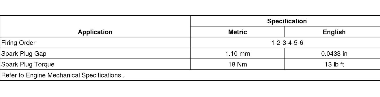

BLUELIGHTNIN6
CERTIFIED EXPERT
16,542 POSTS
Firing order for the 3.1 liter is below.
3.1 liter engine:
Firing order: 1-2-3-4-5-6.
Distributor-less ignition system.
Thanks for using 2CarPros.com!

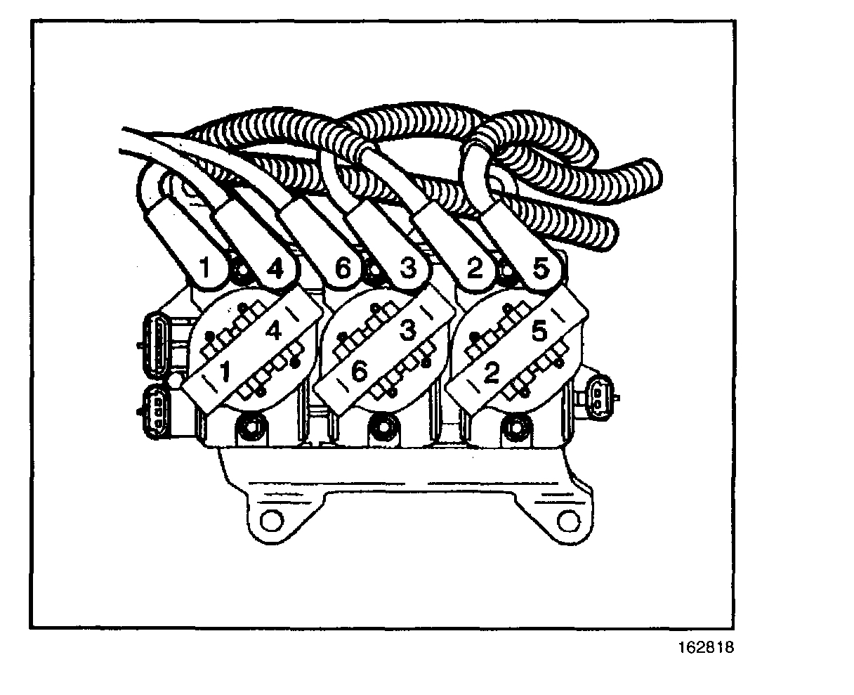

I need a diagram for firing order for coil pack and spark plugs
Sep 19, 2020 at 1:40 PM
(Merged)
CERTIFIED EXPERT
53,854 POSTS
Here is the cylinder order as well (below) Please let us know if you need anything else to get the problem fixed.
Firing Order .................... 1-2-3-4-5-6
