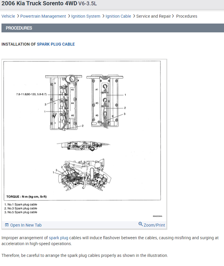

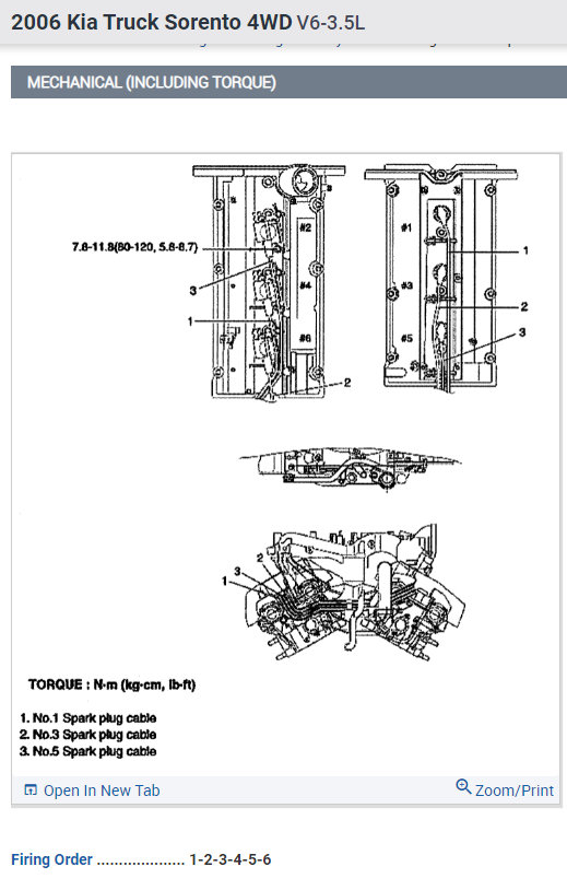

i need the firing order for my vehicle listed above (lx). I need to know where the spark plug wires go to what spark plug wire. like which ones connect from one side to the other. please and thank you
