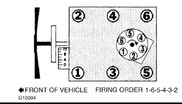

Need firing order for the pickup listed above with a 4.3, 6 cylinder, vortex and firing order for distributor.

Hello, I'm Danny.
Here is the information you requested. I've attached a picture below. Let us know if you have any further questions on this issue or need any other diagrams. Hope this helps and thanks for using 2CarPros.
