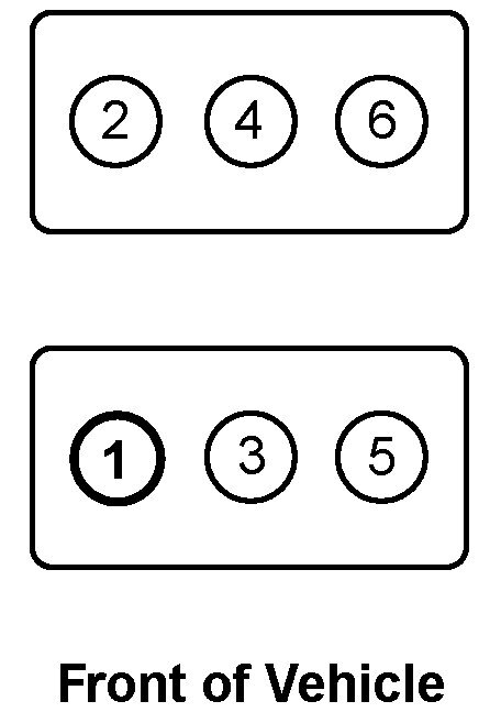

Hi guys, I just need to confirm the correct firing order. I'm not sure of the exact engine size, but it has a v6 in it. Thank you.
Aug 3, 2023 at 7:58 PM
STEVE W.
CERTIFIED EXPERT
15,113 POSTS
1-6-5-4-3-2 is the firing order for the 3.8 in that car.
Image (Click to enlarge)
