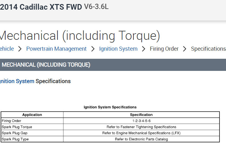

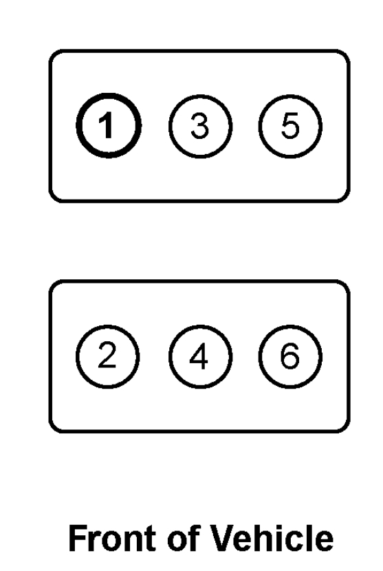

Misfire on cylinder 5 what’s the firing order?
Oct 18, 2024 at 9:18 AM
CERTIFIED EXPERT
53,854 POSTS
Sure here is the firing order and the location of the cylinders to help you find the misfire, this guide may help as well:
https://www.2carpros.com/articles/engine-misfires-or-runs-rough
