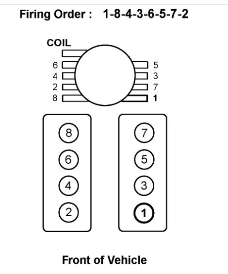

Can you show me the firing order for a 1998 Chevrolet k1500 4x4.
Oct 3, 2024 at 4:43 PM
If you look below, I attached a picture showing the distributor and engine. The spark plug wires will go from the distributor cap and match with the same number shown on the engine.
Let me know if this helps.
See pic below.
