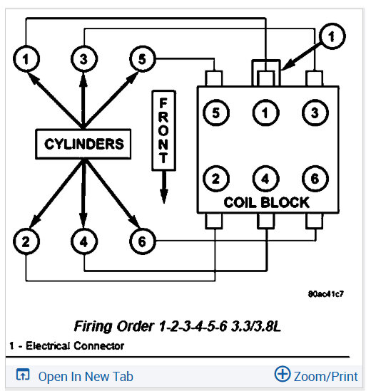

Hi, I'm trying to find the firing order for the vehicle listed above.

Sure, here is the engine firing order for the 3.3 liter engine. Check out the images (below). Let us know if you need anything else.
