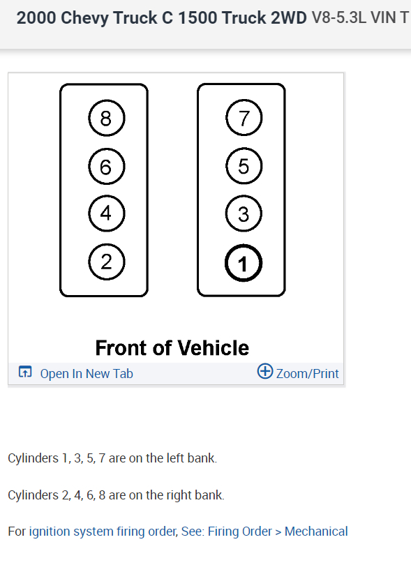

Unsure firing order for spark plugs?
Sep 17, 2024 at 11:23 AM
These engine or coil-over-plug there is no order to the spark plug wires, just straight down to the spark plugs. anyway, here is the firing order as requested.
Firing Order .................... 1-8-7-2-6-5-4-3
