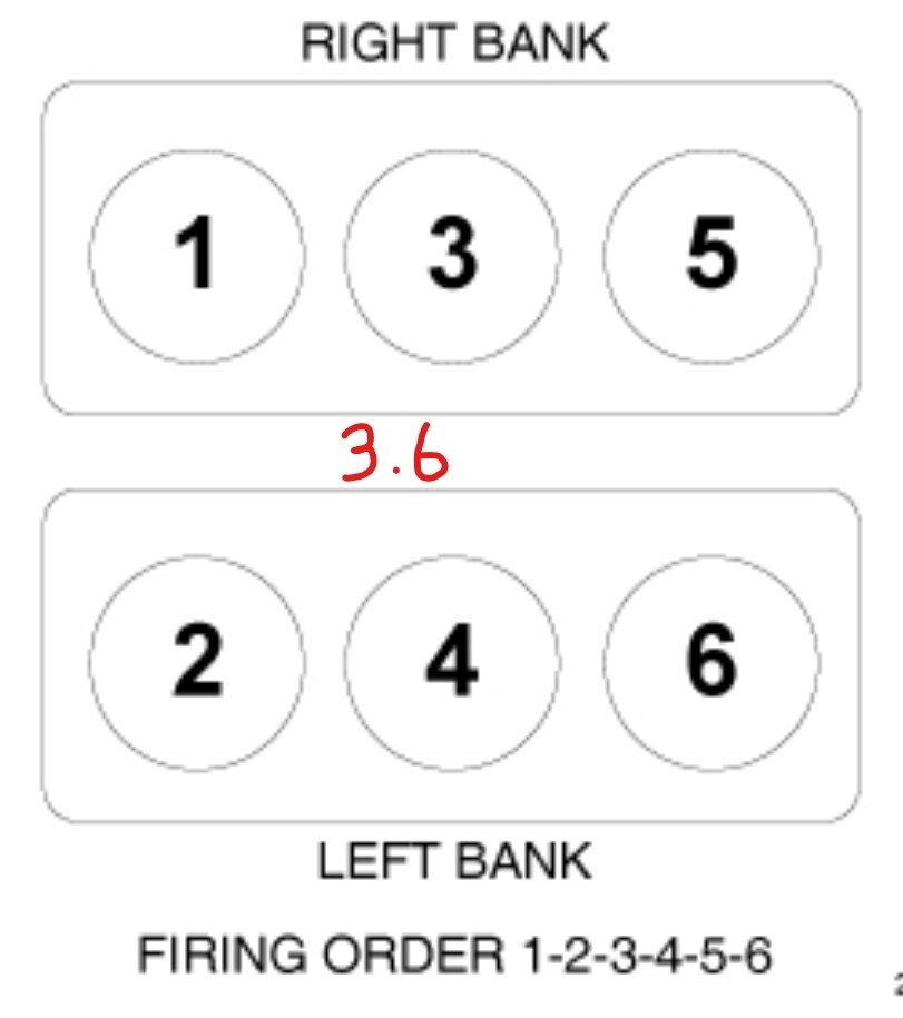

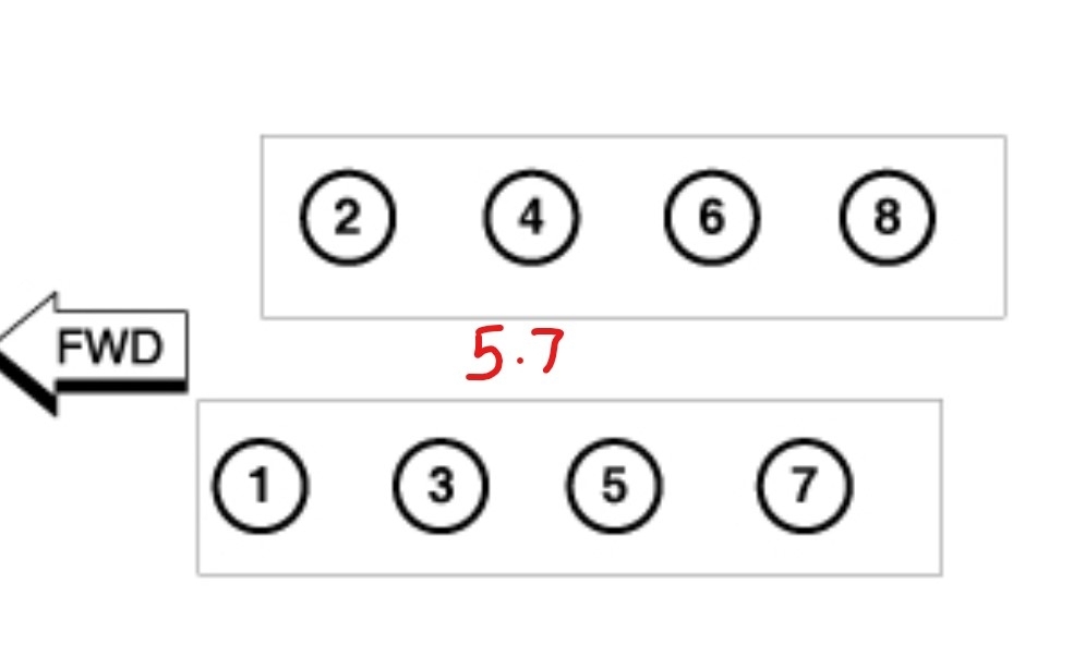

Which is cylinder one please?

On the 3.6 it is the right front cylinder. On the 5.7 it is the left front cylinder. As shown in the attached.
