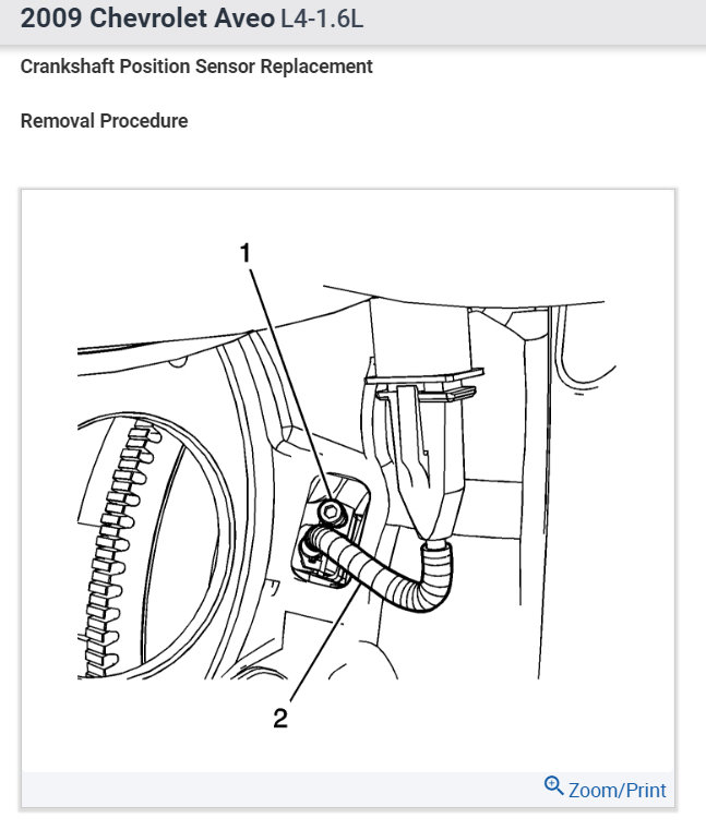

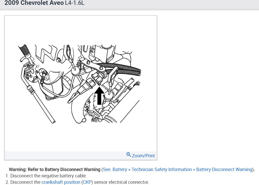

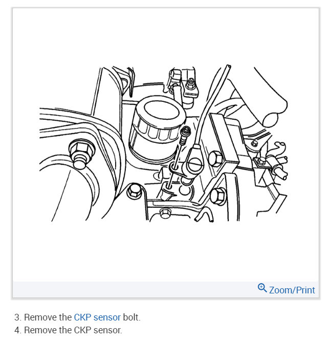

finding location of crankshaft position sensor on 2009 chevy aveo where is it located?
Do you have a diagram of the location of the crank shaft position sensor. I still can't find it.
There emission tube and below it nothing, engine part bolts only.
Does the engine cover have to be removed to see it
When I look at that spot there is nothing there. No wires, nothing else.
I have an ECOTECH engine
Coming up with P0340 & P0365 codes. Crankshaft position sensor?
