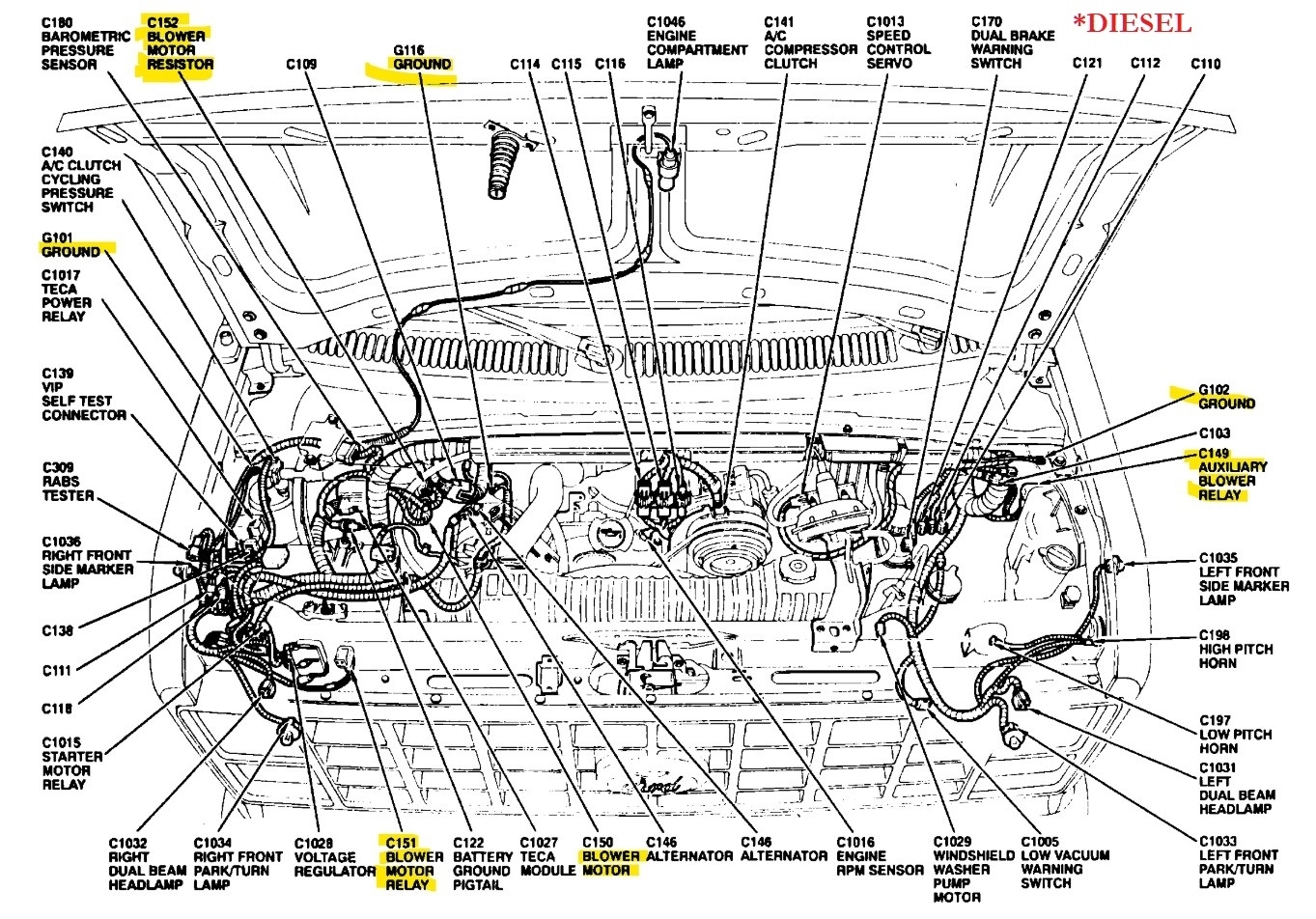

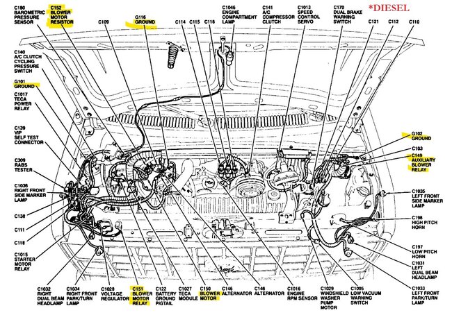

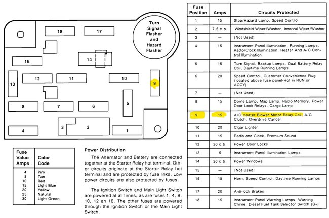

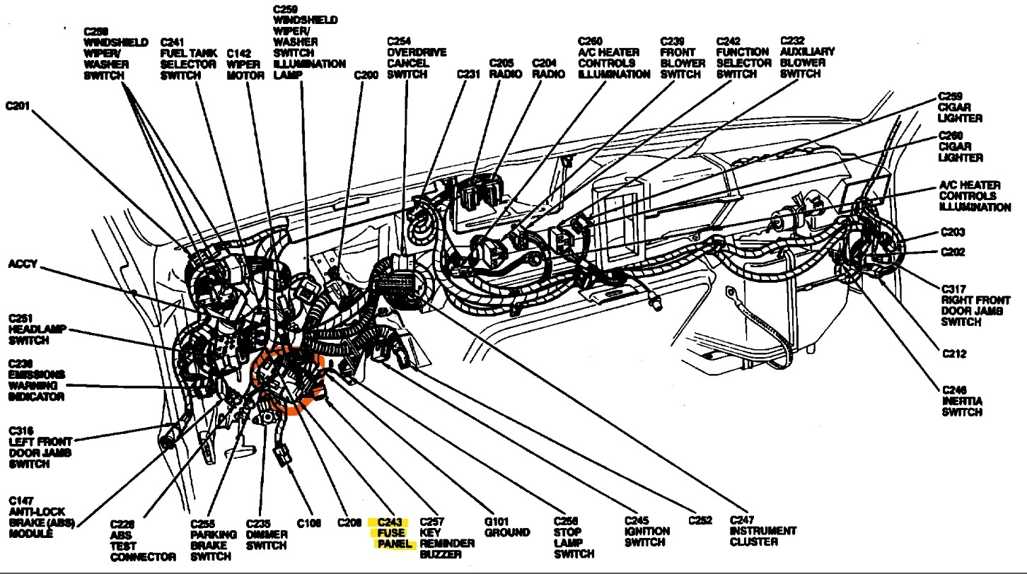

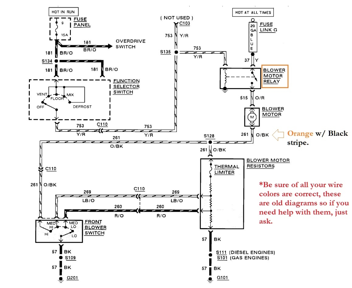

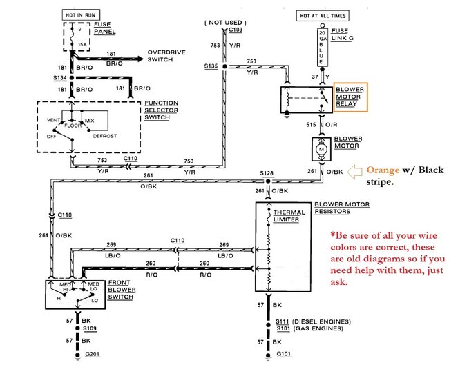

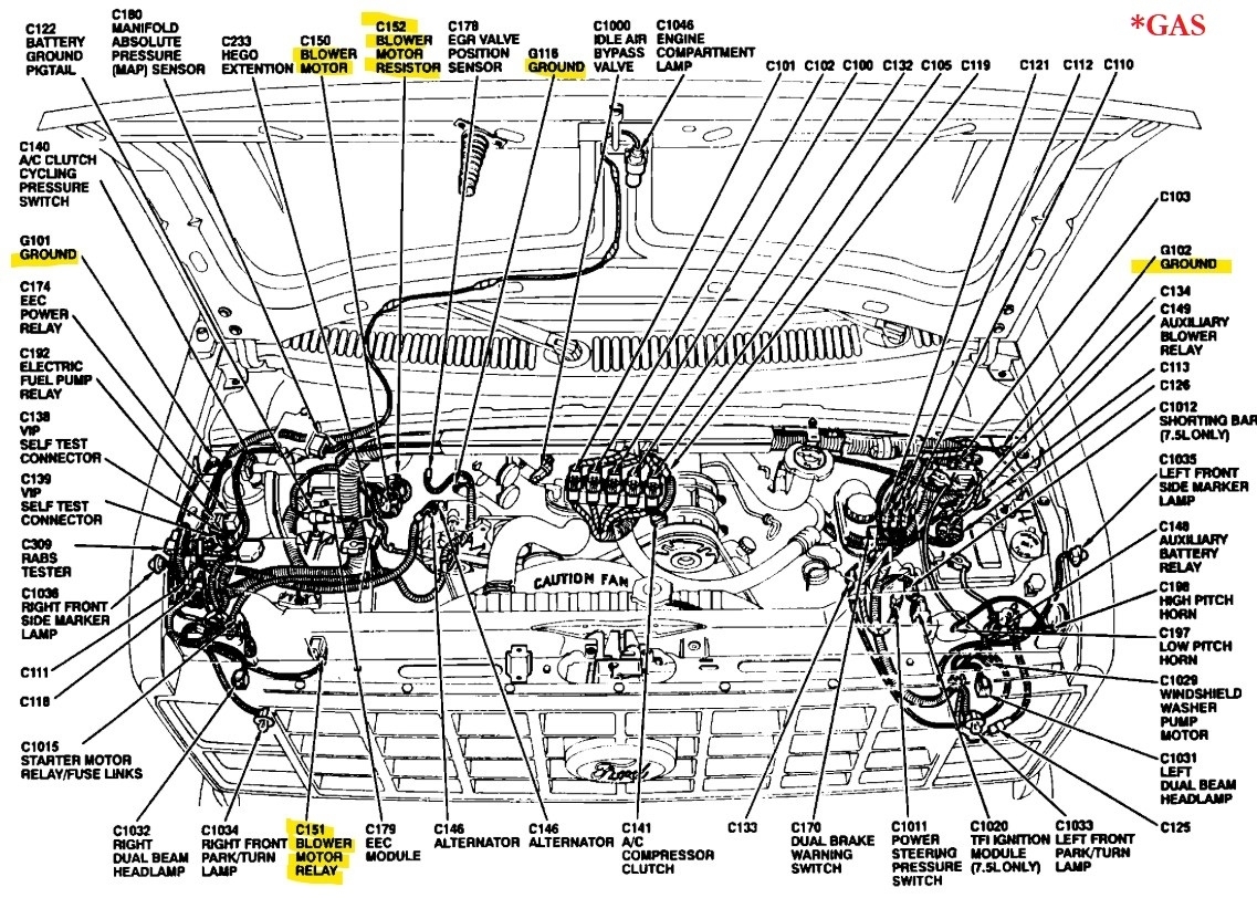

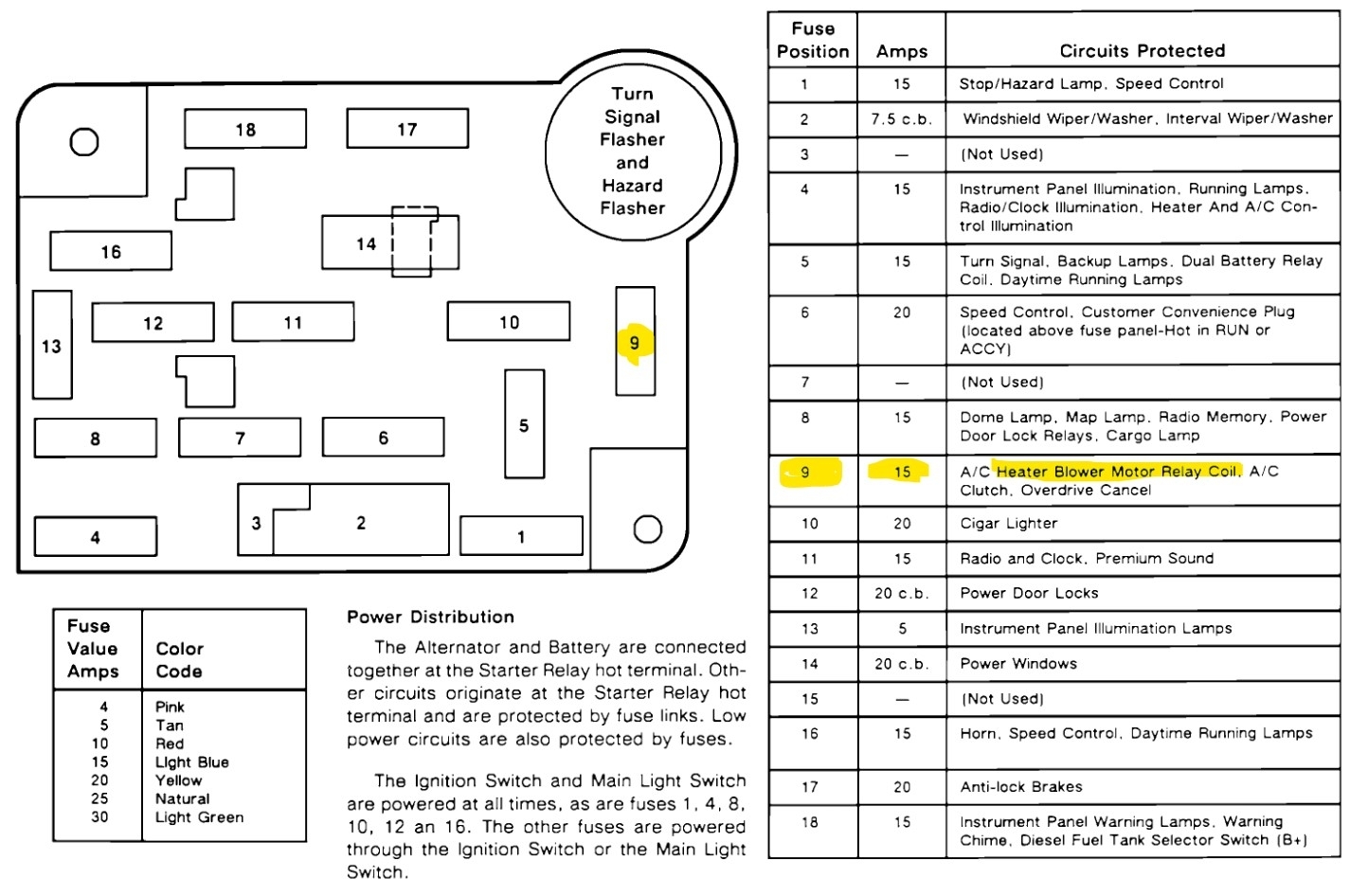

I bought the van used and prior owner made the fan run by attaching the blower motor directly to the battery with two wire leads. We would like to repair this correctly. I bought a relay at O'Reilly but cant find the old one under there! This is a 91 so there's no shiny new plastic parts anywhere. I cant find the underhood fuse panel, if there is one?
