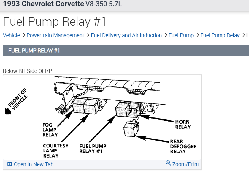

Looking for fuel pump relay rear window defogger horn relay supposed to near the fuse panel right side passenger interior how to pull the relay?

i made a mistake it is a1993 corvette c4 40th anevirsty

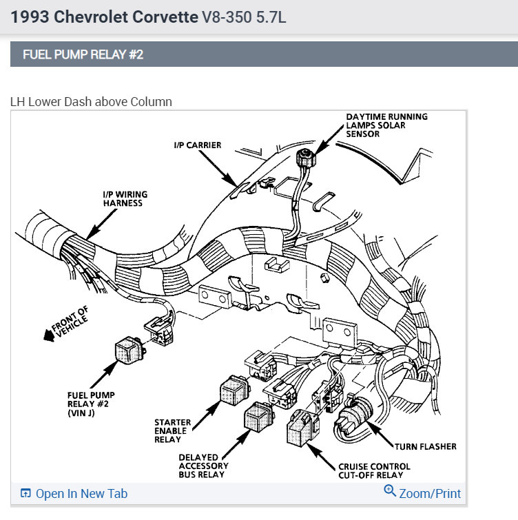

There are two relays for the fuel pump or two locations. Please check it out in the images below. Also, I have included a guide for you to check the relay operation.
Check out the images (below). Please let us know if you need anything else to get the problem fixed.
