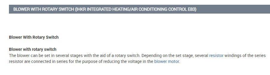

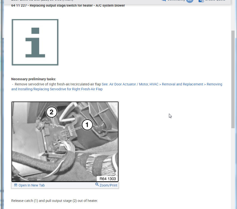

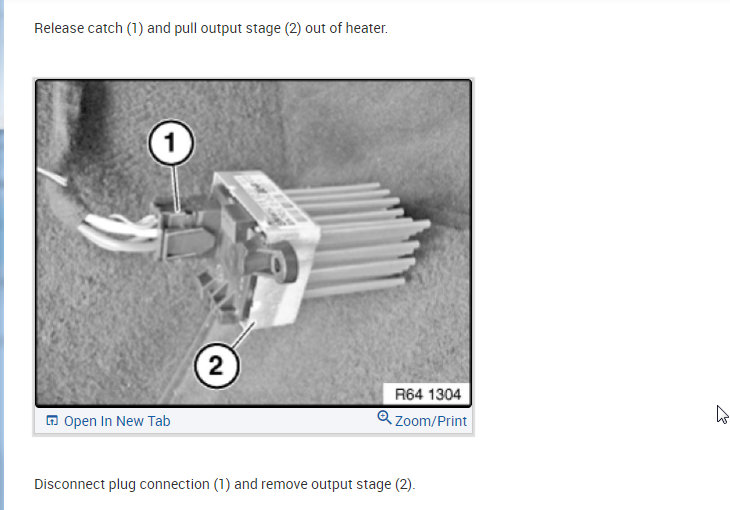

Unfortunately we don't have a manual for the specific UK spec because we are located in the USA, but we do have one for the e83. What I can't tell you is if this is different here in the USA vs UK.
I attached the info that we have below. Hopefully that gets you what you need. Thanks
