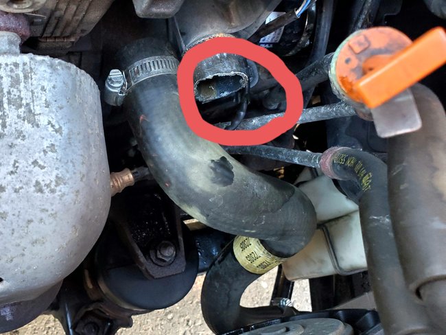

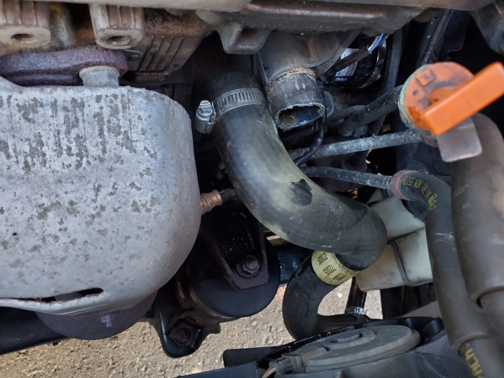

Yep, you can replace it. And you nailed it. It is simply called a thermostat housing.
As far as breaking, it is really odd that it did, but it's plastic so anything is possible. Is the broken part still inside the hose?

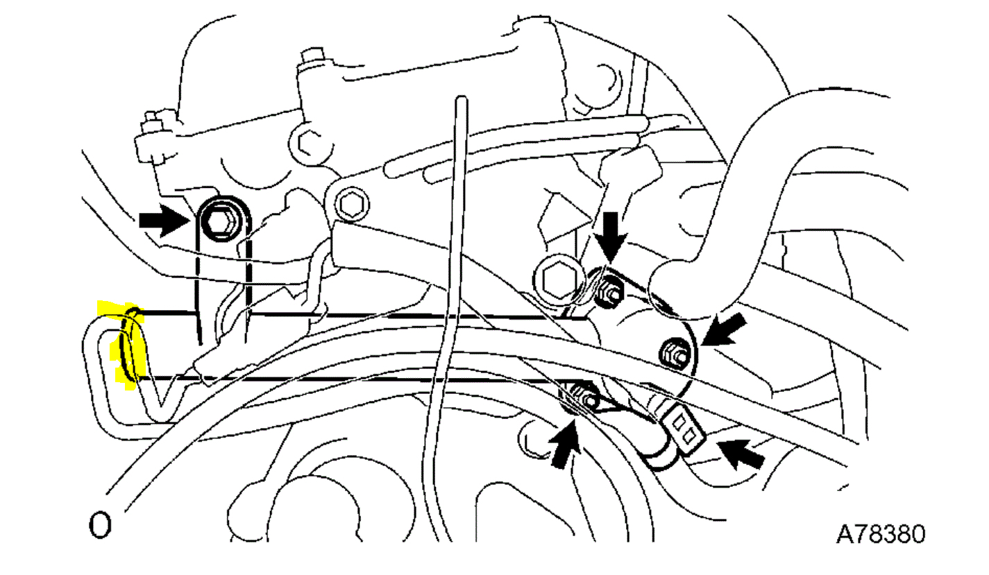

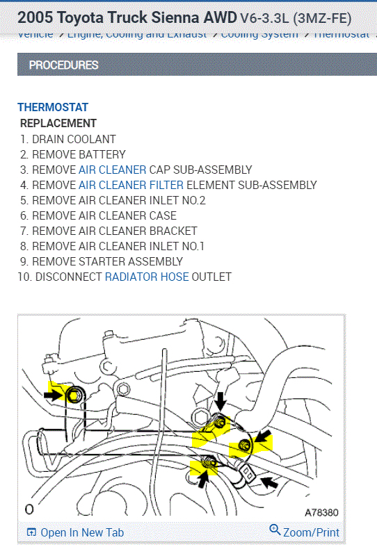

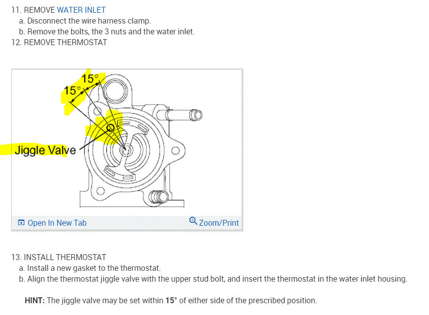

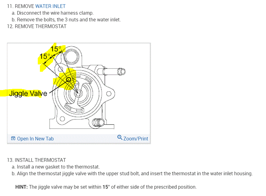

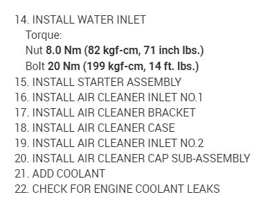

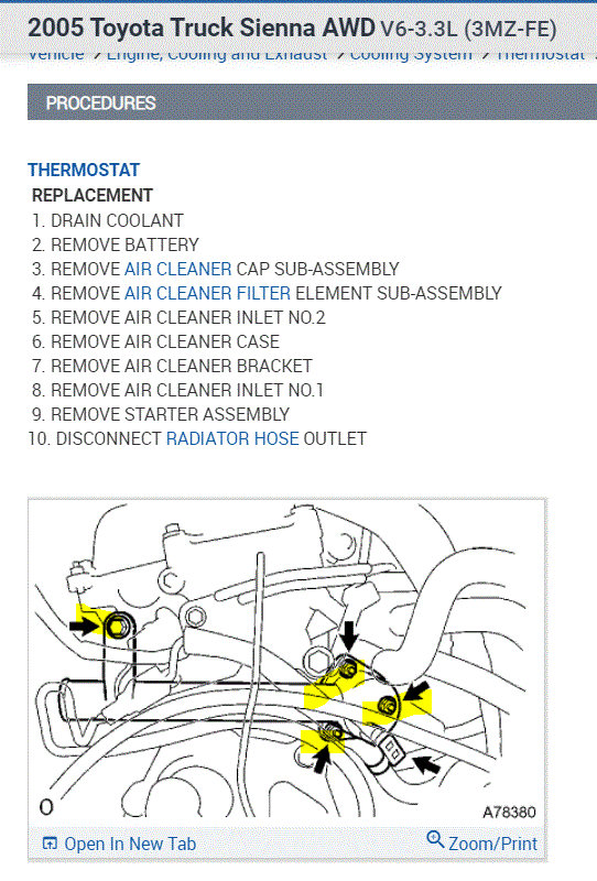

I attached the directions for replacing it below. If you look at pics 1 and 2, I highlighted points of interest. In pic 1, I highlighted the bolts holding it in place. Note: There is also an electrical connection that will need unplugged. In pic 2, I highlighted what is called a jiggle valve. That is on the thermostat itself (which I would replace at this point). Make sure that is positioned correctly. It allows air to exit the cooling system while refilling the coolant. If you point it directly down (6 o'clock) it will be very hard to bleed the system.
The worst part about this job is the starter needs to be removed. Make sure the negative battery terminal is disconnected before working on the starter.
Now, the housing won't be hard to find. It should be under 30.00 dollars. Make sure when reinstalling it to replace the thermostat gasket, which should come with the housing.

I'm here to help if you need me. Let me know if you run into trouble. Also, make sure to get a universal type of coolant when you refill the system. That way there won't be any issues.

See pics below.
