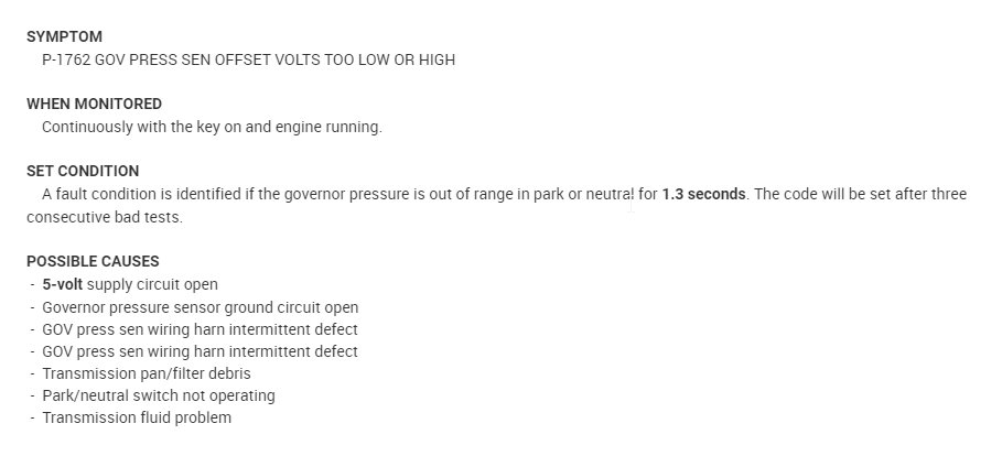

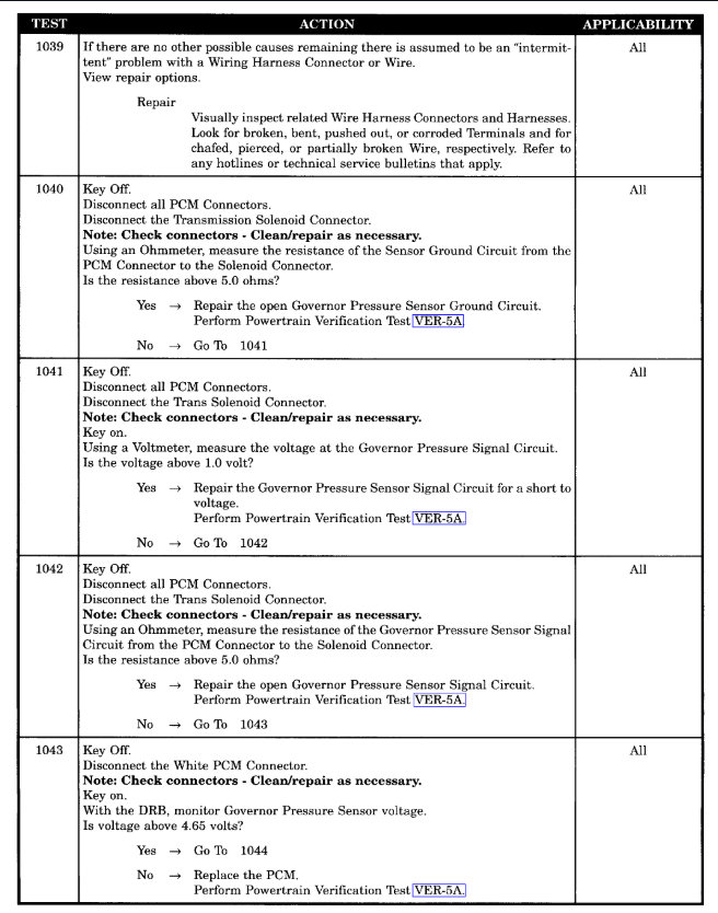

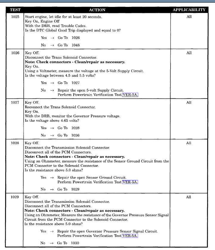

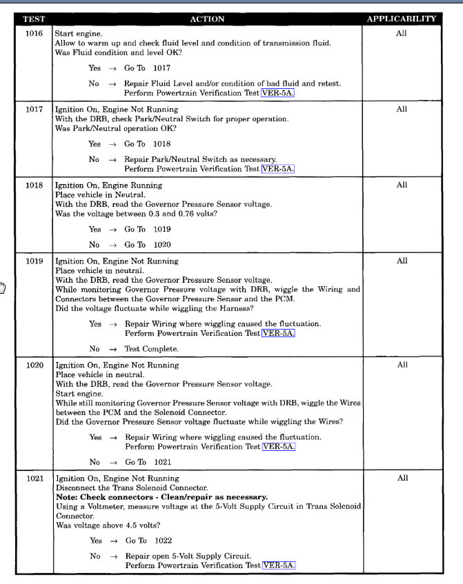

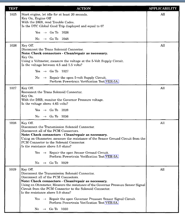

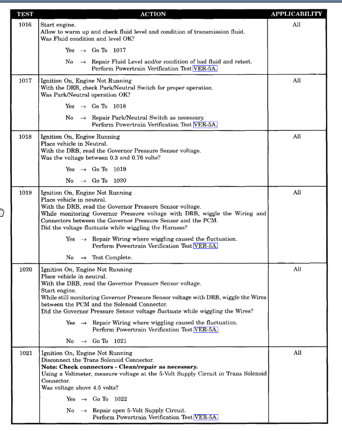

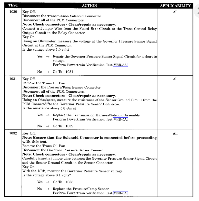

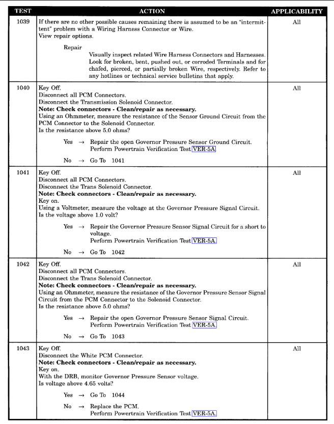

P1762 - Gov Pressure sensor volts too low or high

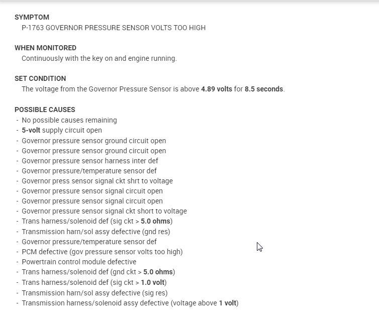

P1763 - Gov Pressure sensor volts too high

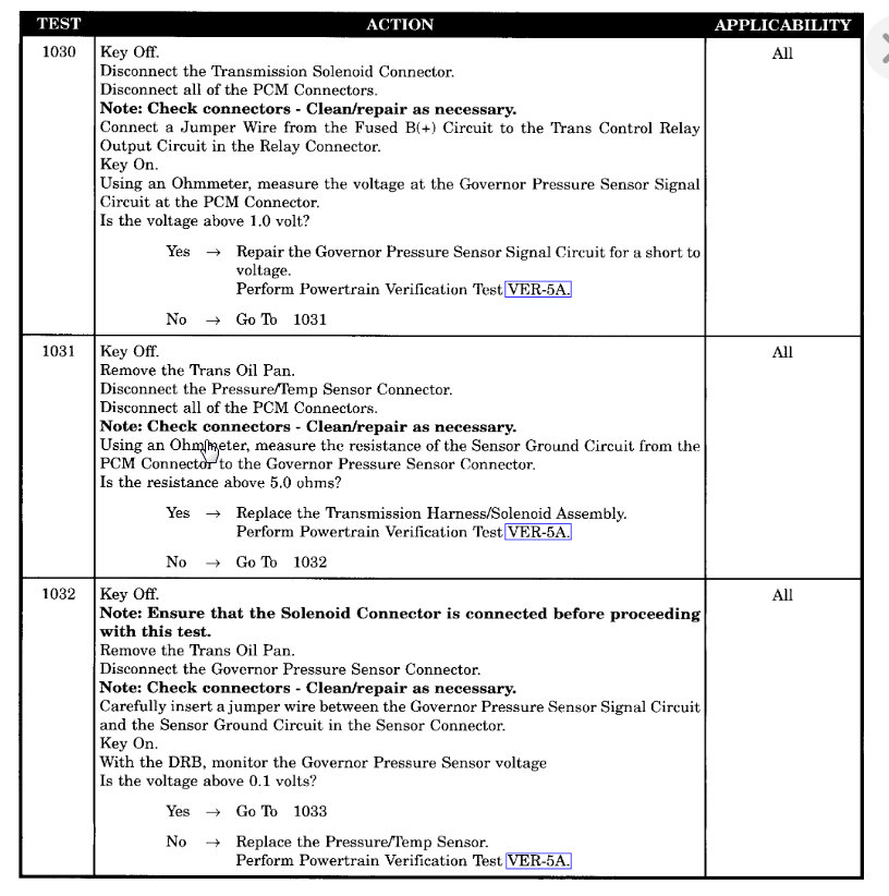

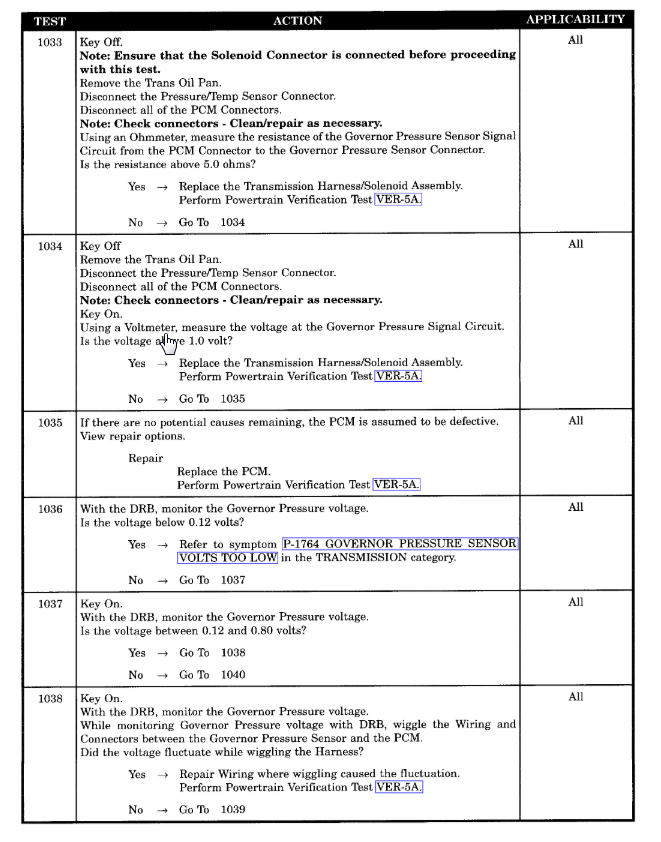

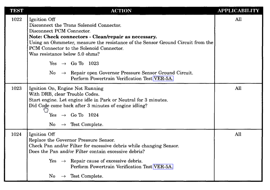

I attached the testing for these codes that we need to run through. I would suggest starting with the P1762 code and see what you turn up. Clearly we need to check the fluid and make sure that is okay but after that, just run through this. There could be internal damage but I would start with these tests because clearly this sounds like a governor issue which is where I was going with my thinking earlier so this just confirms it.
I suspect both are relate and the 1762 testing is less involved then the other so if we solve that issue then that it may fix it all. Let me know what questions you have. Thanks
