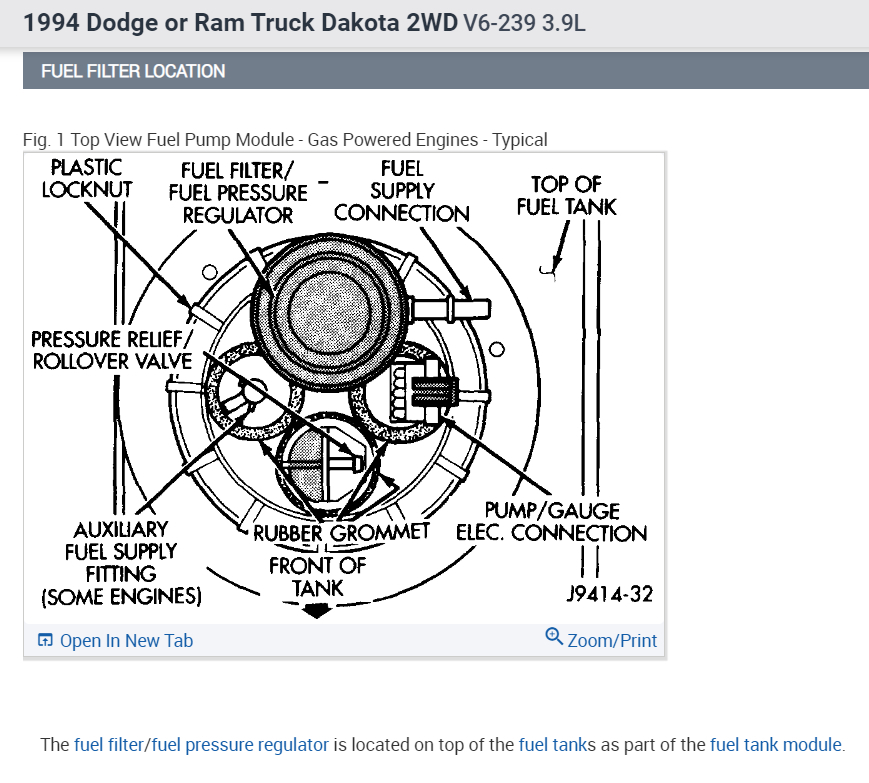

Truck is running a little sluggish and hard starting. My sister bought an external fuel filter but I've checked all along the frame and can't find the filter anywhere.
Oct 2, 2022 at 8:11 AM
The fuel filter is on top of the fuel tank. Check out the images below to see what I am talking about. Check out the images (below). Please let us know if you need anything else to get the problem fixed.
