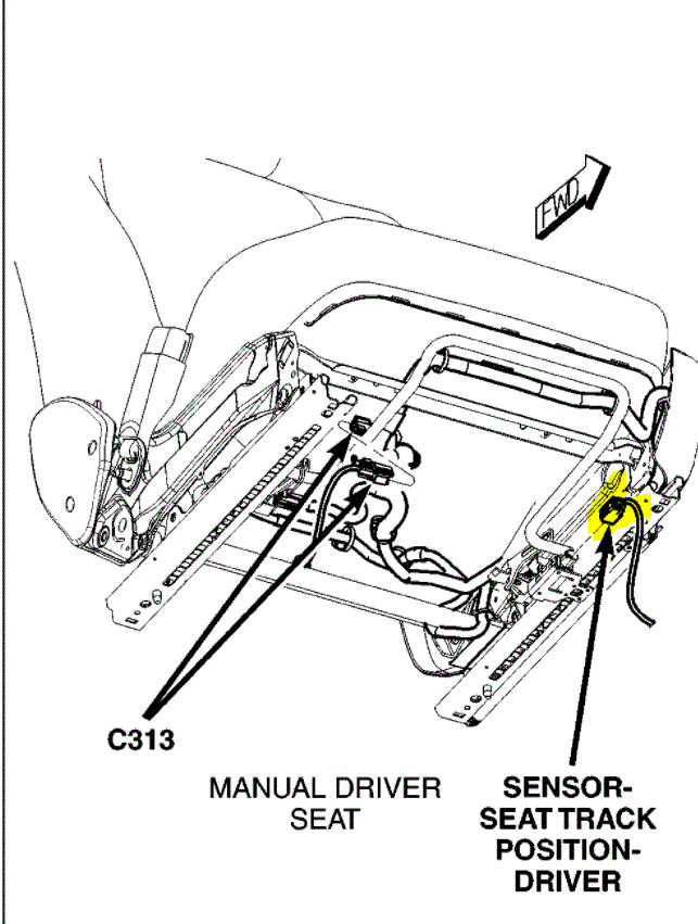

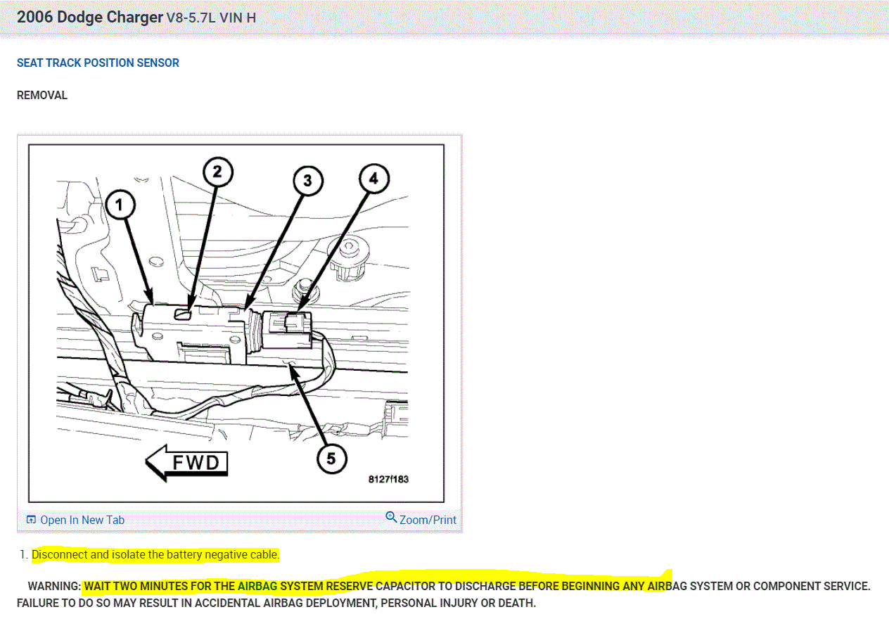

As far as the issue, first inspect it to make sure the wire to it is not damaged, broken, or disconnected. See pic 1 for location.

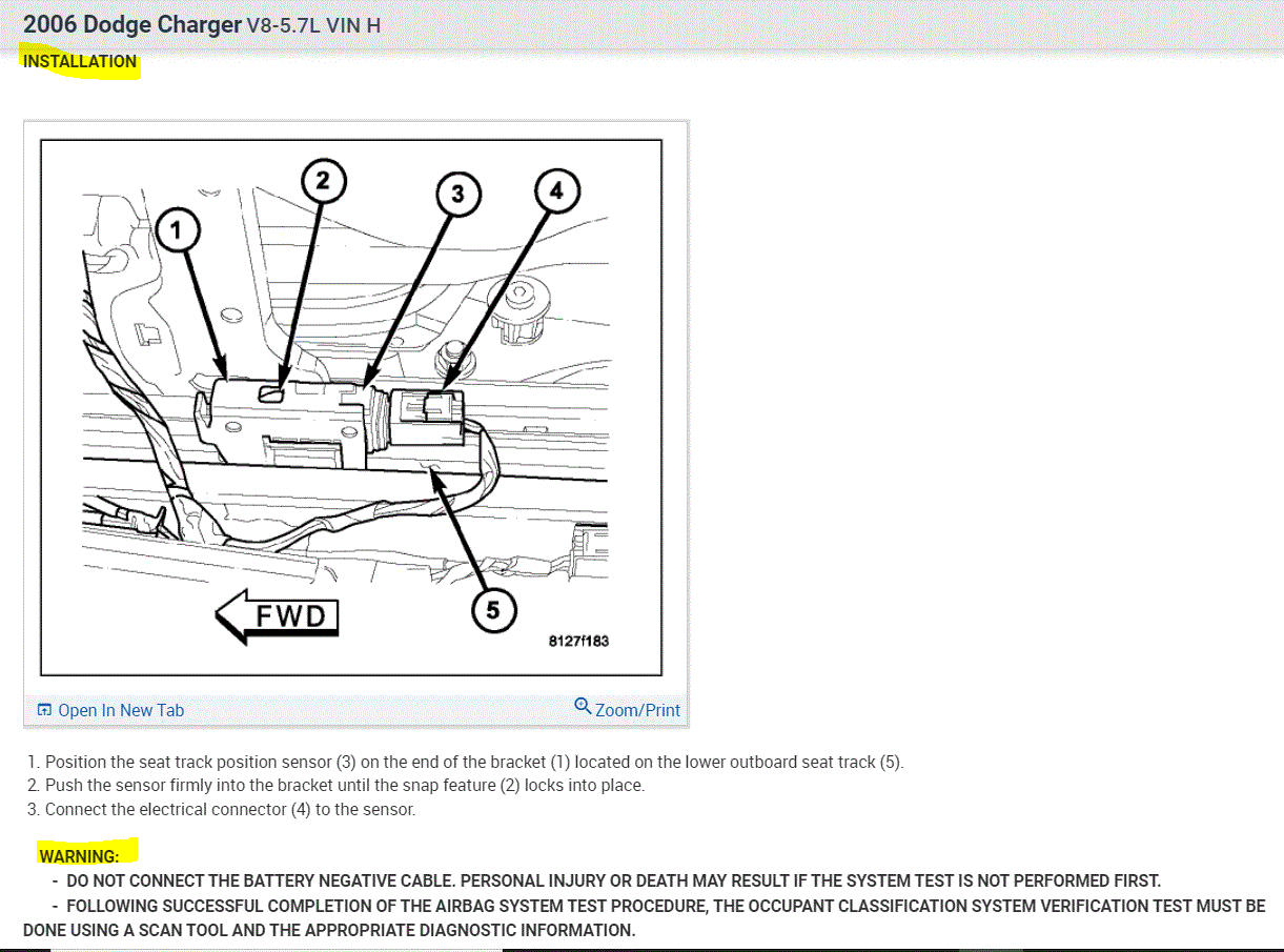

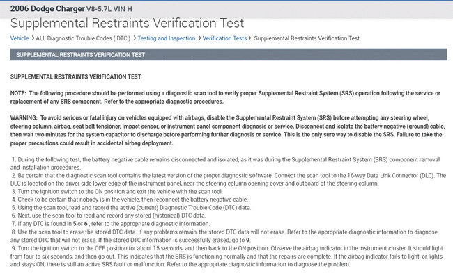

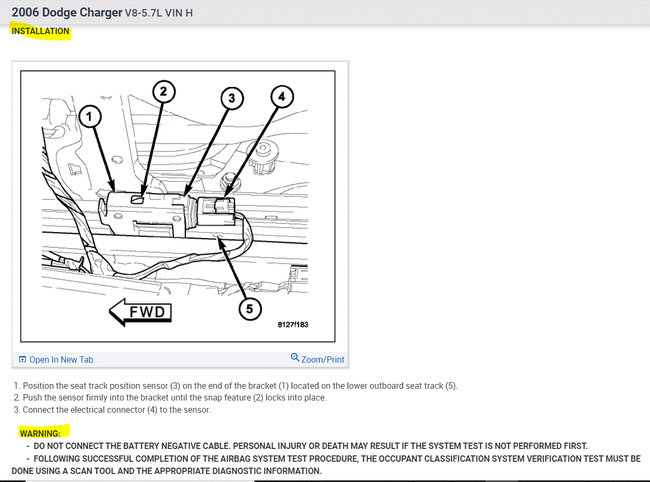

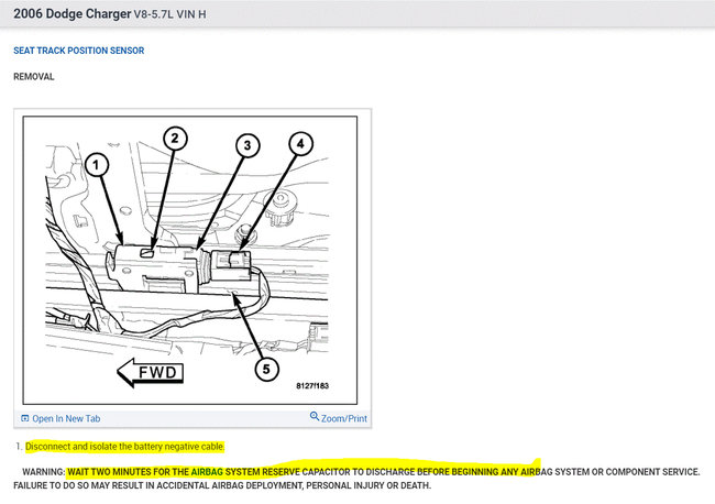

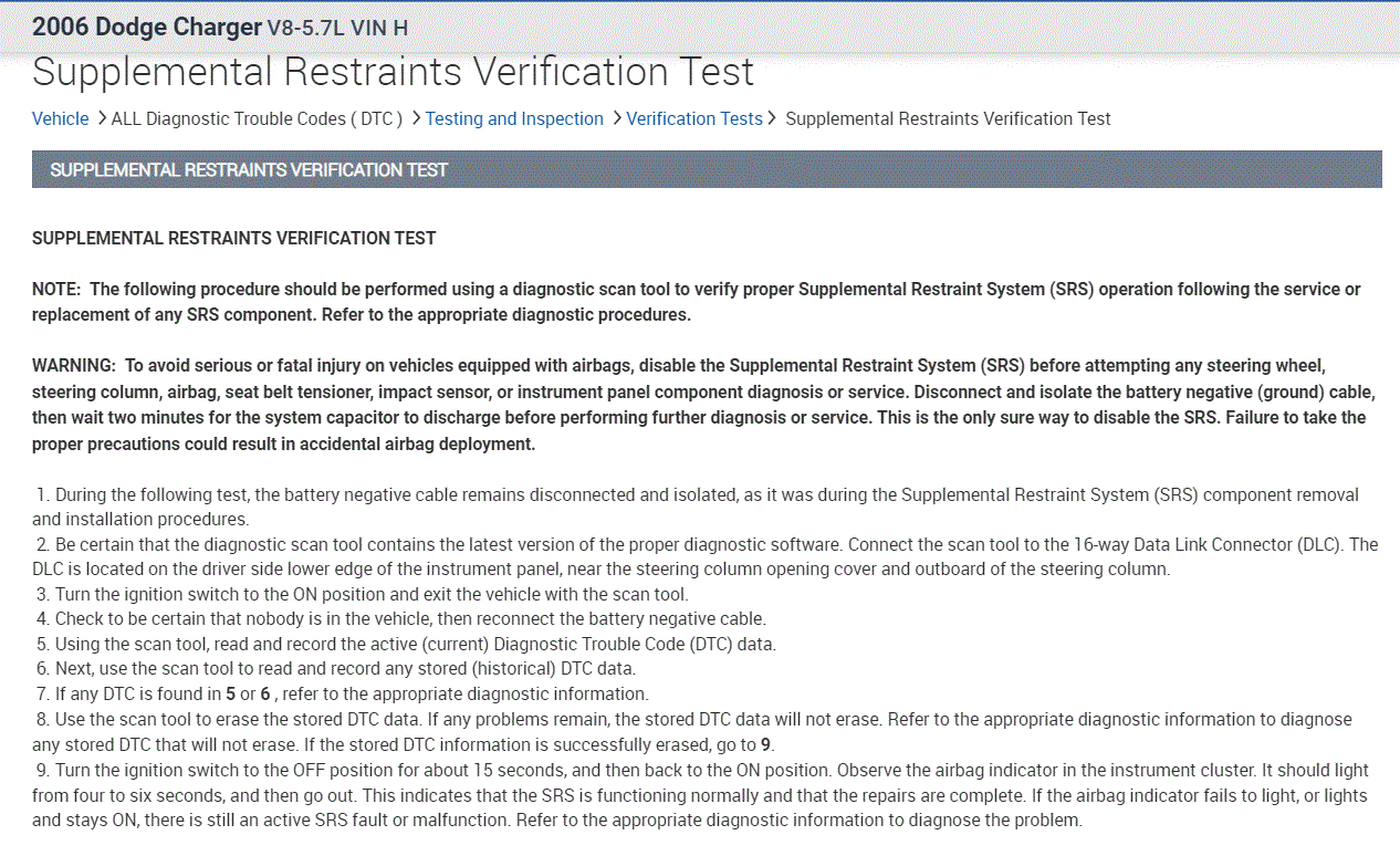

If you look through the remaining directions, they are for the removal and replacement of the sensor. Please note the warning in pic 2 and the last pic. The last pic indicates the need for a scan tool.
