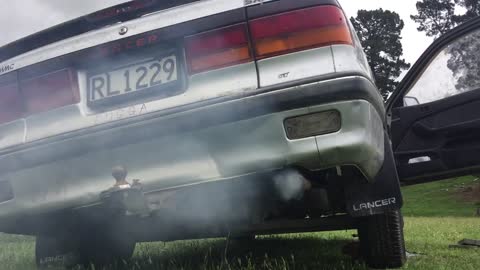

Hi, fuel is not getting to first or second fuel filter. so i'm thinking that it's the pump. in most other cars the pump is under the seat but mine is not. just wondering if i would have to drop the tank or not. thanks

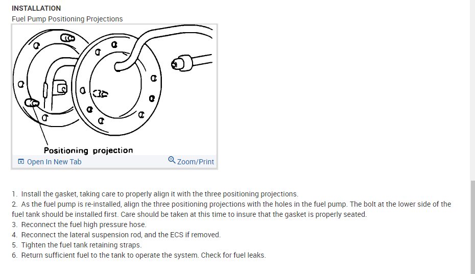

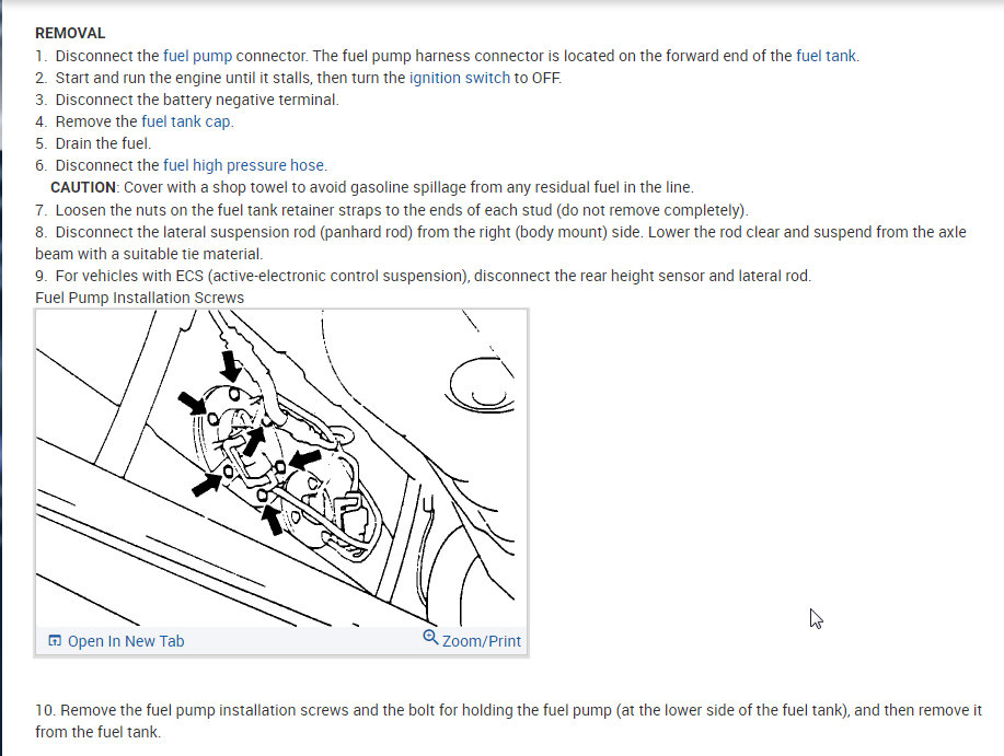

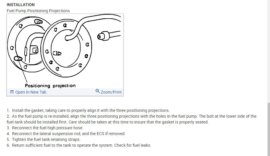

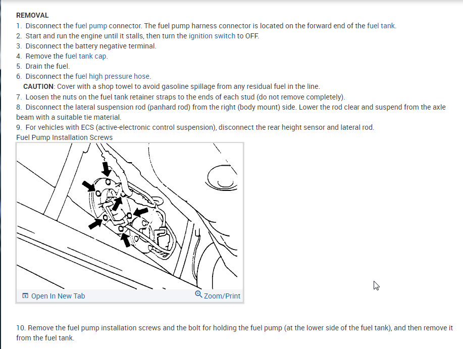

I am attaching the process from the USA version of the Lancer. They did not offer the Lancer in the USA in this year so we don't have that specific vehicle but the Galant was basically the same vehicle. You are correct that this is removed from under the vehicle.
As for the issue, I am not sure this is a pump issue. If it is running like that with all that blue/white smoke I think you have other issues.
