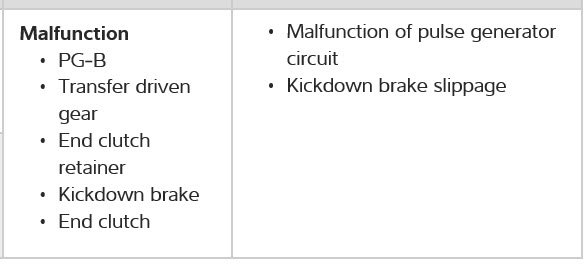

The car does not shift into forth gear, and code p0734 is set. i changed out the transmission with another one (used ) and nothing changed. I also changed the PCM with another one (used ) and nothing changed. i noticed that oxygen sensor is not working properly. My question is, can the oxygen sensor faulty or engine misfire effect on transmission shifting into forth gear only and set code p0734?

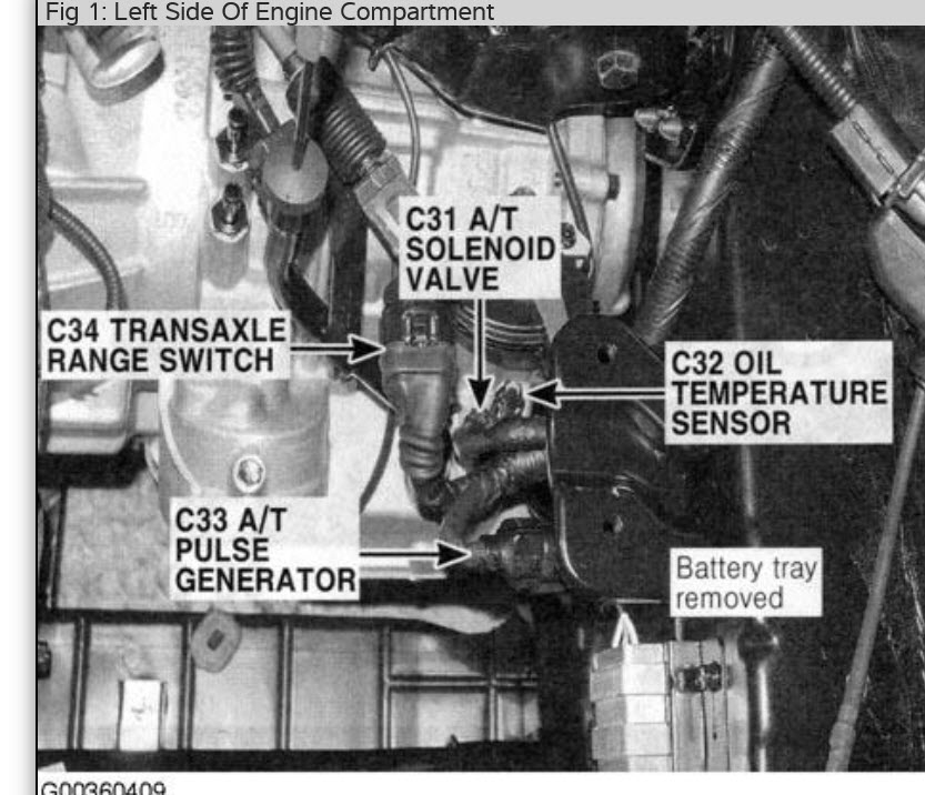

have a transmission professional check this, it may be the pulse generator on the transmission or the clutch or what is in the pictures I am sending you are going bad.

thanks for your help , i will check this pulse generator , but i have changed the transmission and same error happened ,so it may be the pulse generator harness wire ?and can you tell me where i can get this program with this pictures you attached ? than you again and sorry for my English
