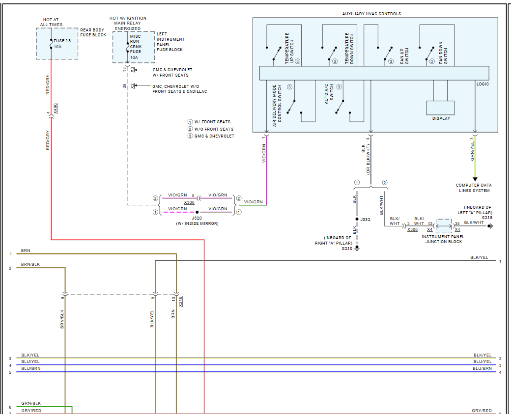

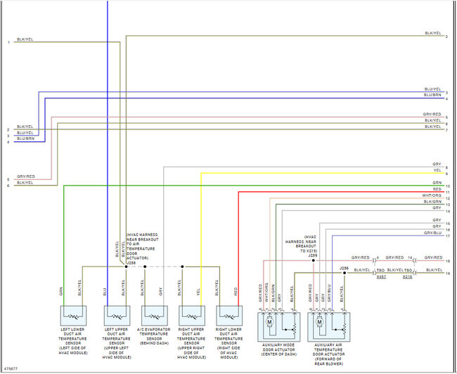

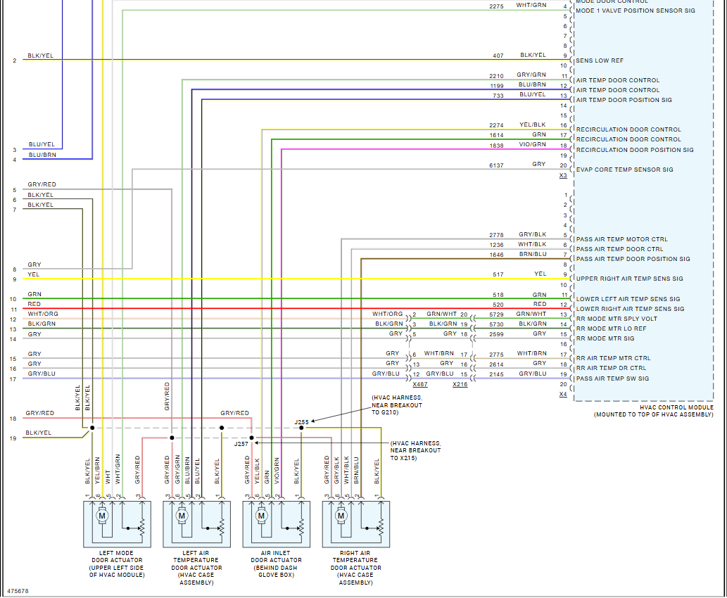

I have a problem with the A/C. It is not working sometimes. Could you please write wiring diagram for all items connected to A/C sensors and LIN BUS? Where is A/C controller/driver? What does it mean U1511.00? When I connected the car to scan tool there was information, that there is not connection to AC/LIN. What shall I check or do? I am waiting for your reply.
Have a nice day,
Pawel
Nov 28, 2024 at 9:15 AM

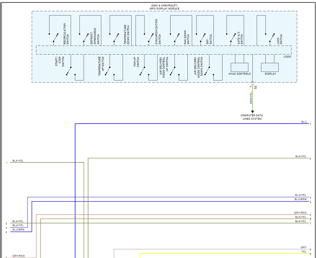

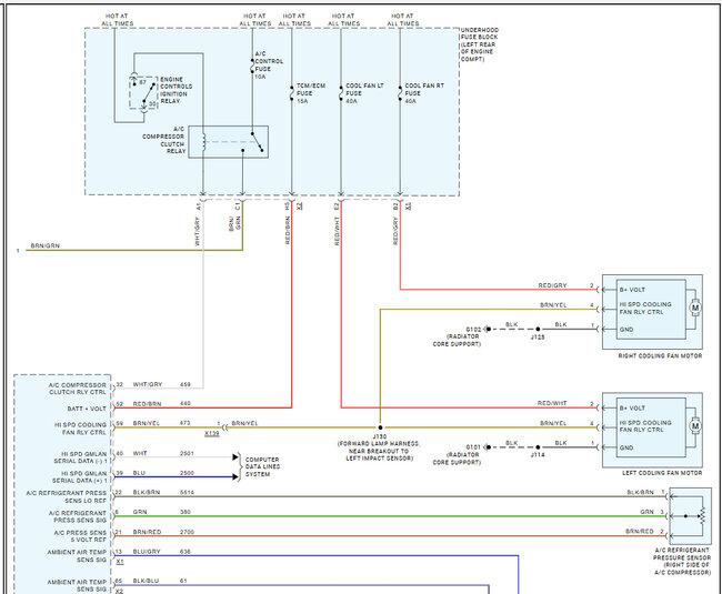

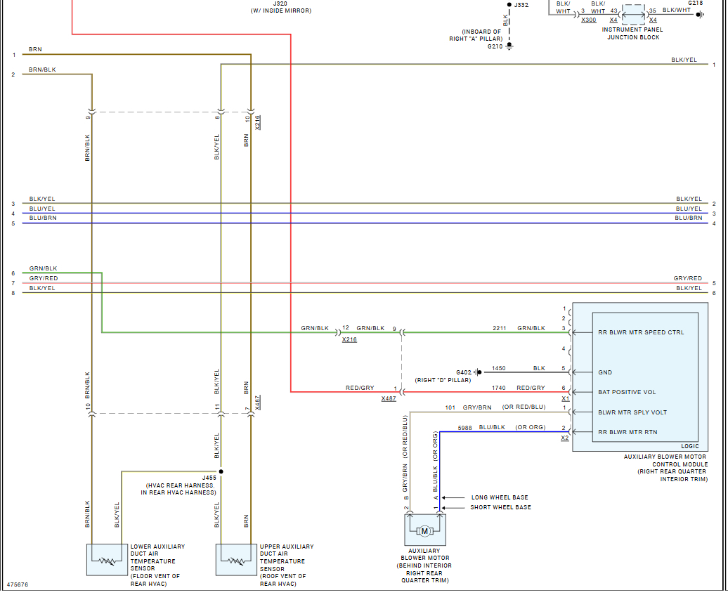

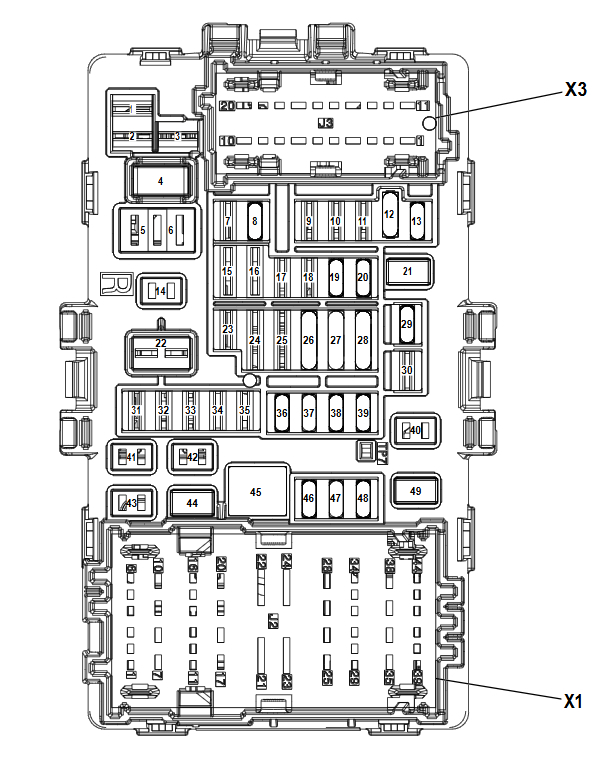

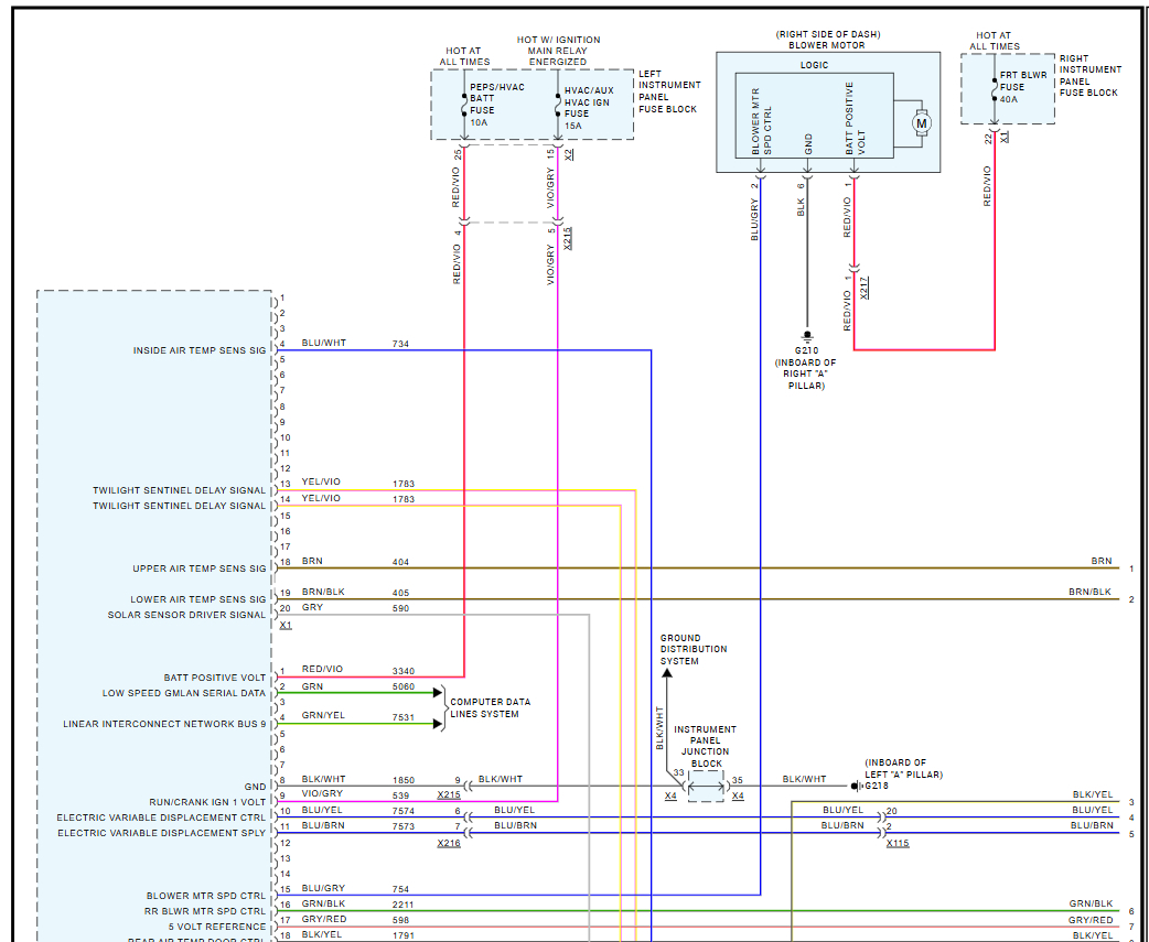

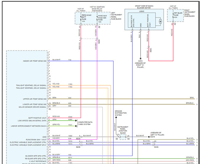

The first thing I would do is check the battery voltage which should be 12.4 standing, this guide can help:
Replace the battery if it fails the test and clear the codes.
U1511: Lost Communication With LAN.

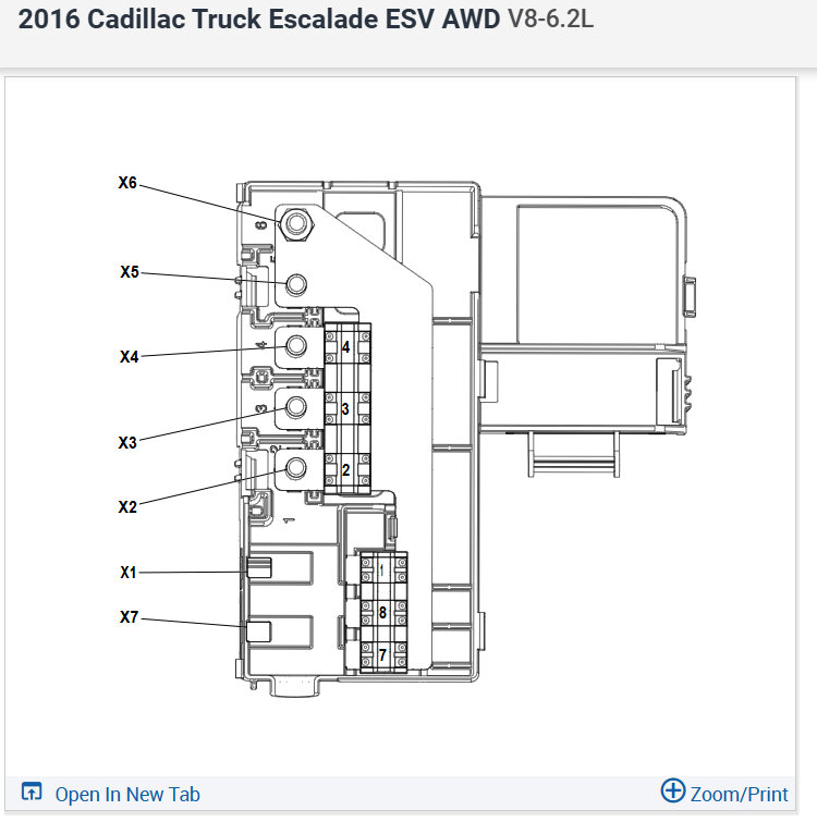

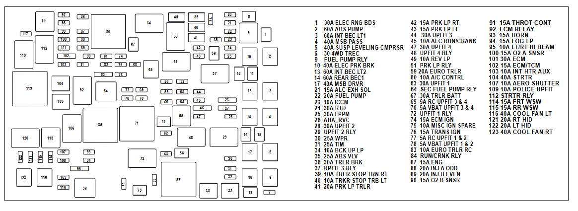

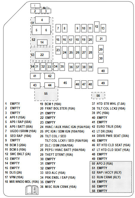

Next, I would check the fuses using this guide:

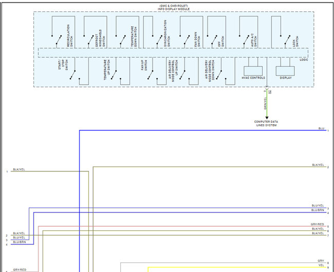

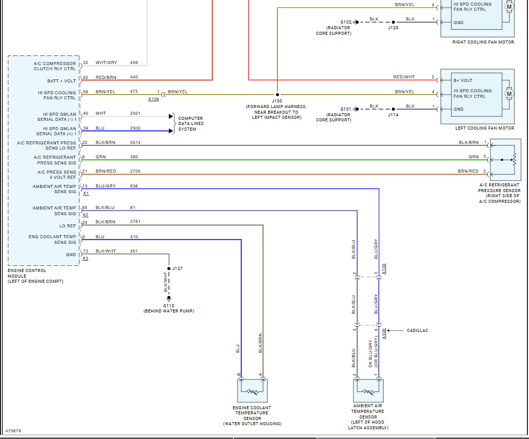

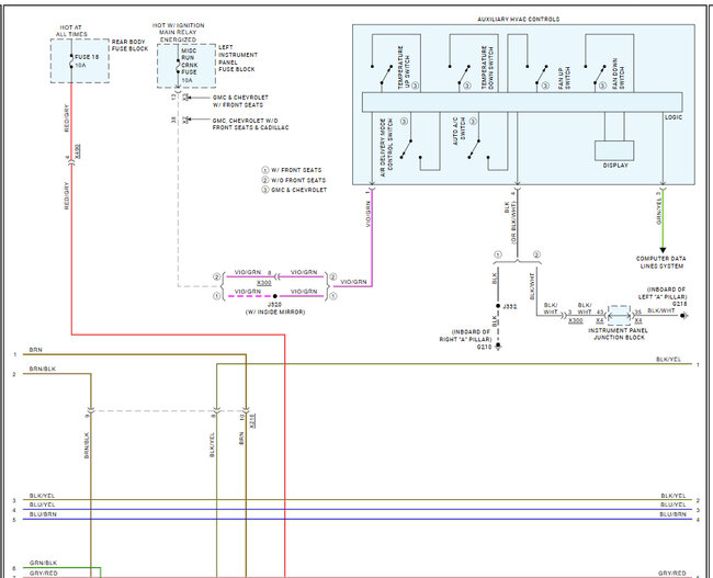

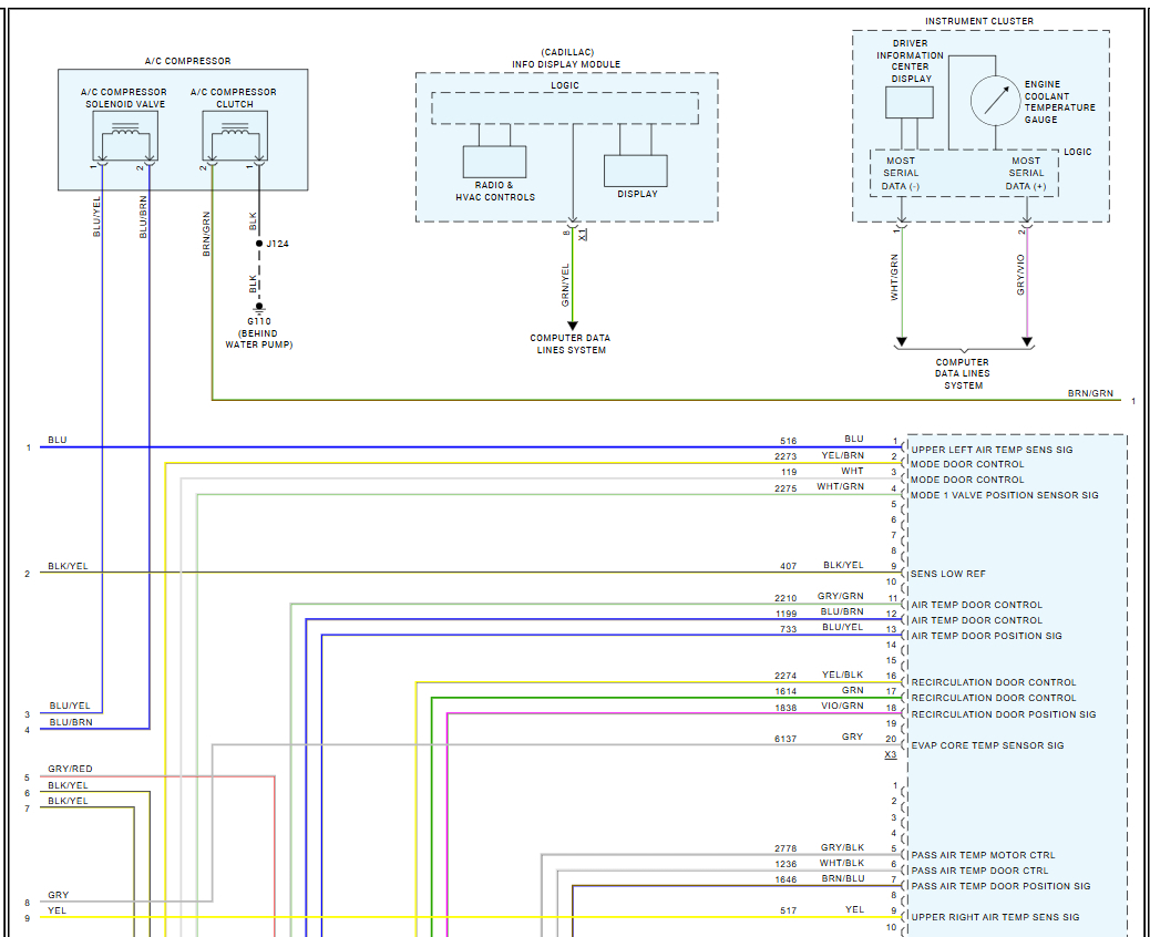

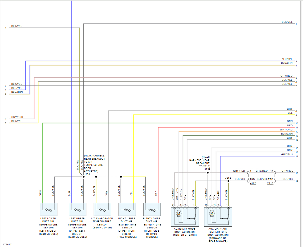

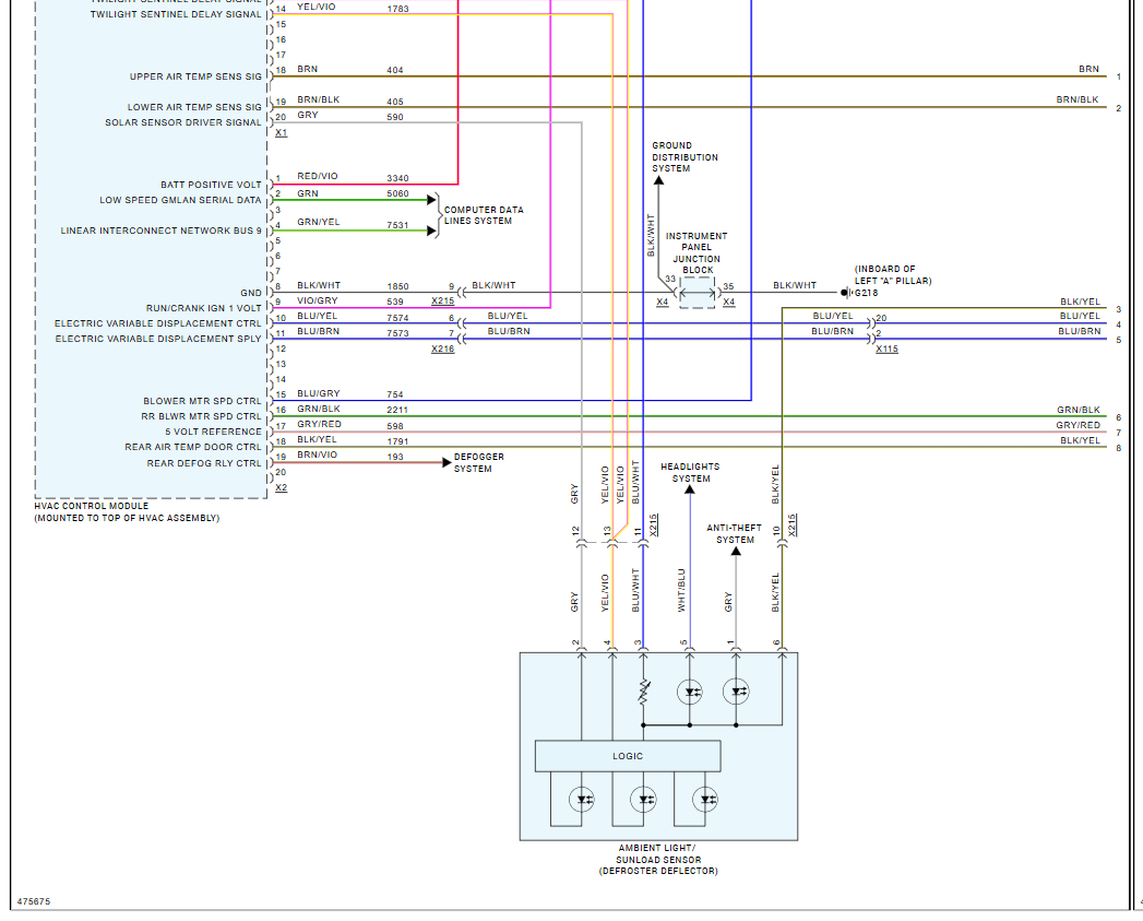

Here is the fuse locations and I have included the AC system wiring diagrams so you can see how the system works, and the sensors involved. Check out the images (below). Please let us know what happens. Please check the fuses with the key on.

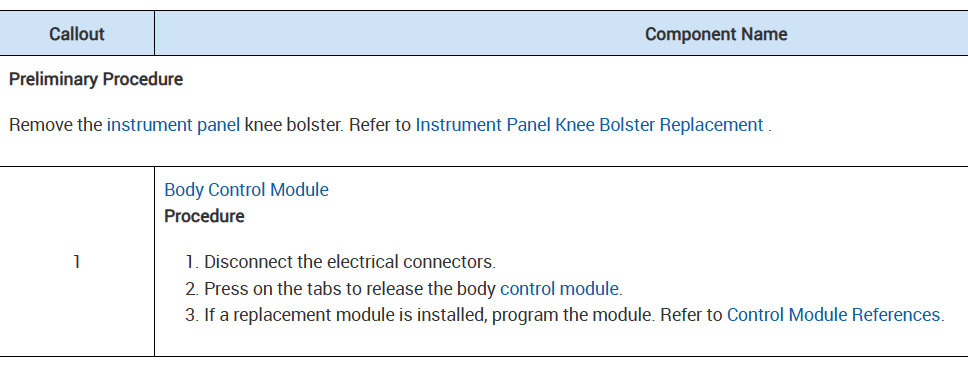

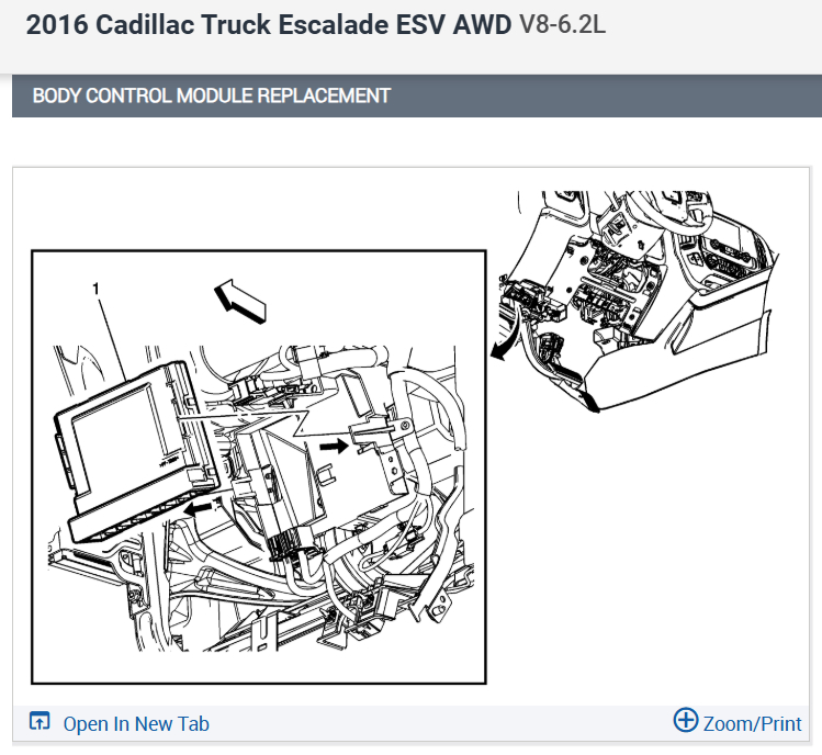

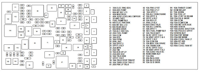

I was going some research and the EBCM can be out which might cause these issues. Here is the location of the unit so you can get a preprogrammed unit by searching Google or Ebay. Check out the images (below). Please let us know what happens.
Dec 2, 2024 at 9:54 AM

1. Is it safe to replace EBCM with other used one? No one sensor in car will lost "memory"? Should I program the new EBCM or should it start working at once?

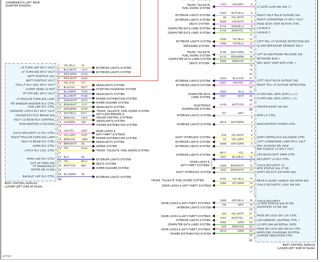

2. Could you please add wiring diagram between front bumper and EBCM? EBCM have some different connectors. Which one connector (plug) on EBCM goes to front bumper.
Dec 2, 2024 at 11:24 PM

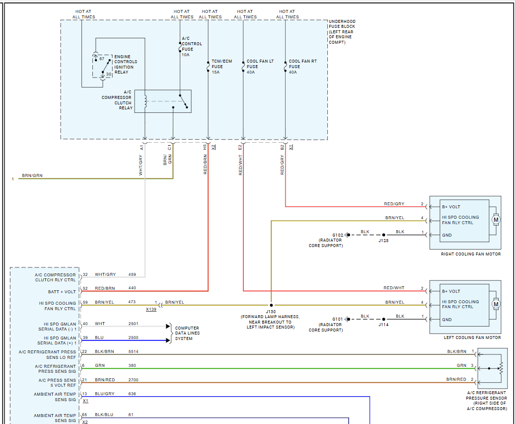

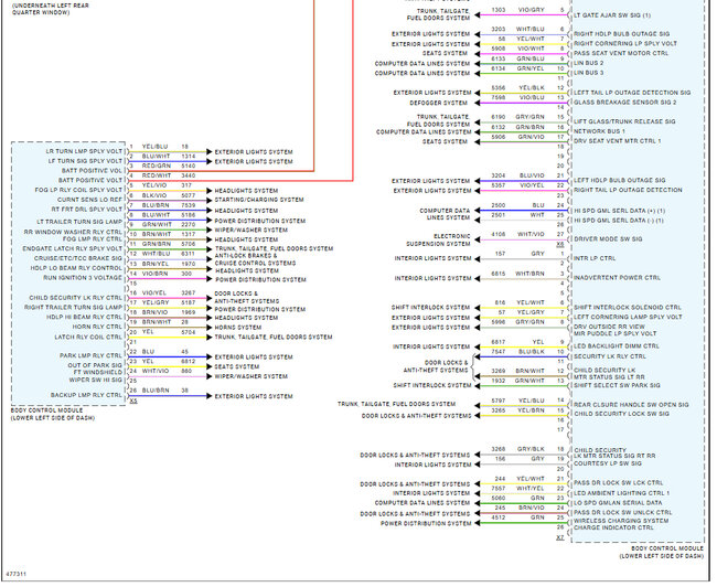

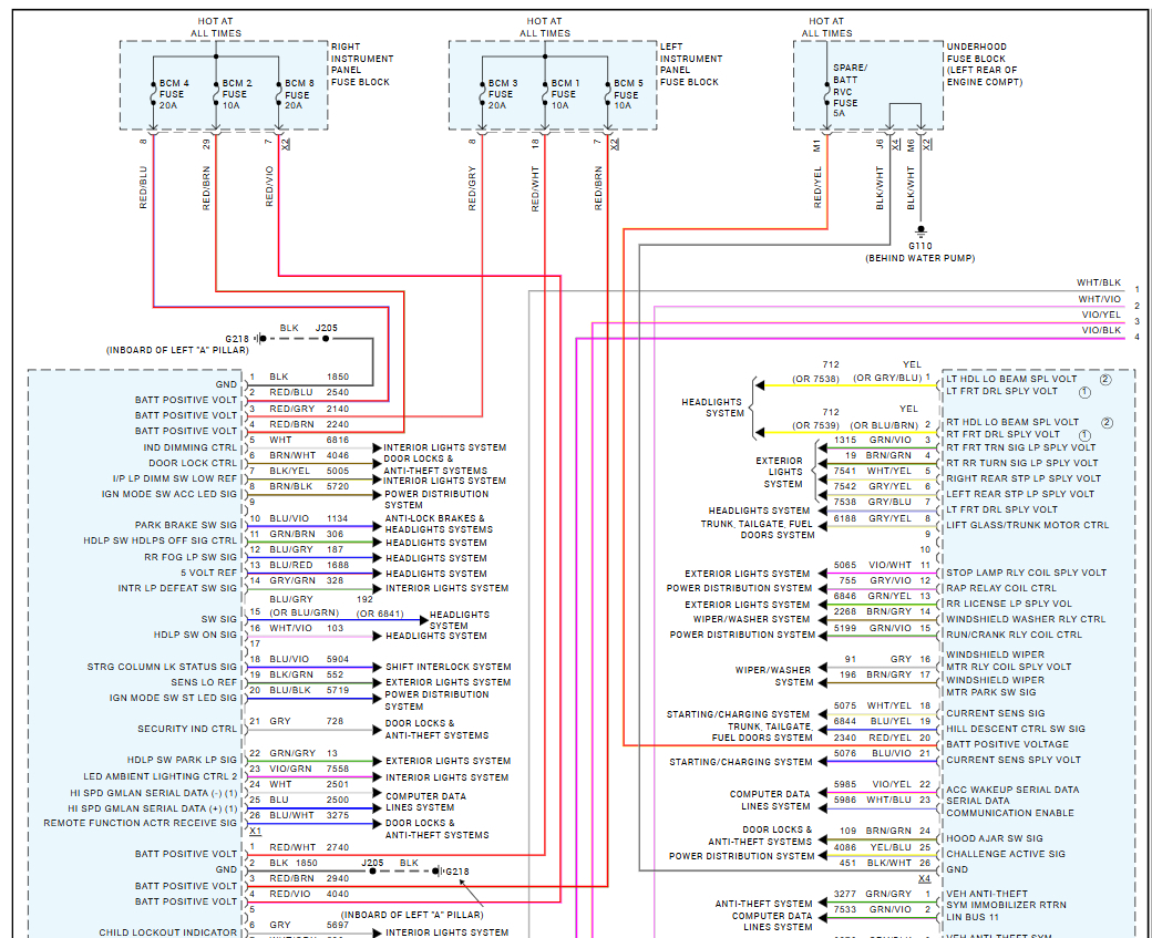

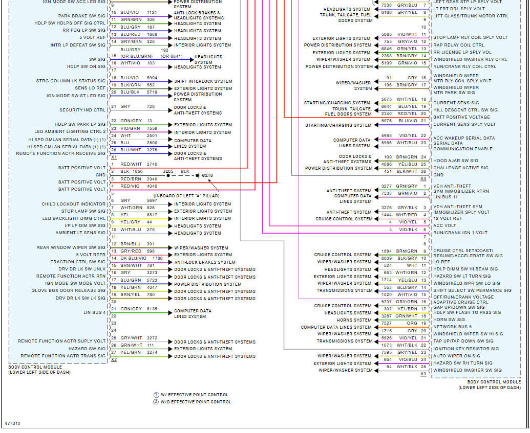

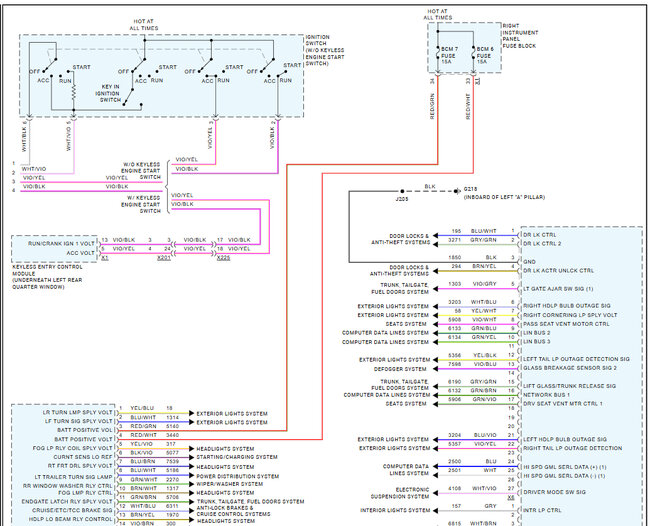

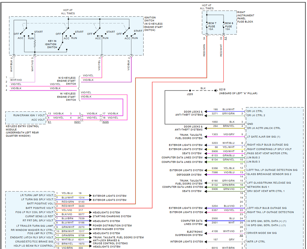

The replacement BCM needs to be programmed before it will work so you can't just plug one in. You can get them preprogrammed if you search google or eBay for a service that does so. Here are the wiring diagrams for the BCM, I would recheck the fuses for the BCM as well. Check out the images (below). Please let us know what happens.

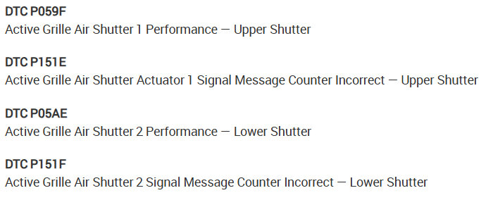

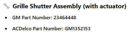

Hmm, no information I have or on the web says anything about the U1511 code being the shutters? Here are the shutter codes FYI.
U codes are for the network, here are the shutter part numbers, please let me know how it goes. Check out the images (below).
Mar 25, 2025 at 11:11 AM
PAWEL_N
  • 178 POSTS
Thak you for your reply. But the number GM1352153 is described as Front Driver Side Interior Door Handle (Standard Line) for Chevy. Are you sure that is it part number for shutter?
Mar 25, 2025 at 11:33 PM
The part number info came from Ai so no. They don't give the part number in AllData. There is only one mention of the shutter on the web for this code. The rest are all over the map. I would call the dealer for the part number, if it works, please let me know I am interested. Be sure to clear the cods once the repair is made.
