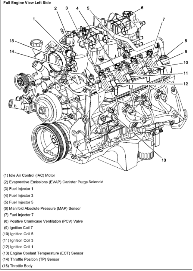

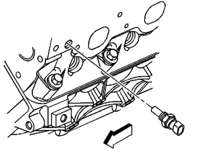

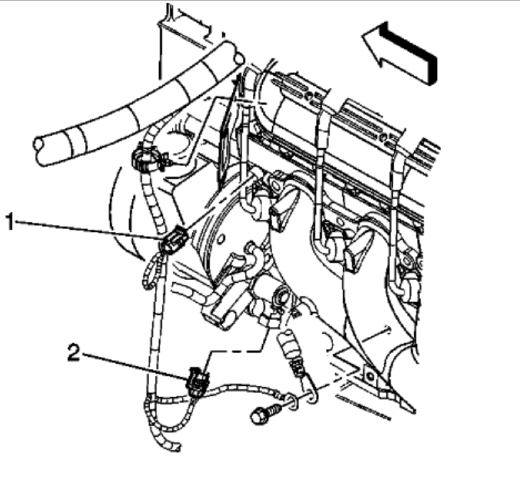

To me it sounds like you have a engine coolant temperature sensor that is off slightly not enough to cause a check engine light but enough to create a engine runnability problem.
Here is a guide to help you see what you are in for what changing the sensor out:
https://www.2carpros.com/articles/coolant-temperature-sensor-cts-replacement
Below is the location on your truck.
Check out the diagrams (below).
