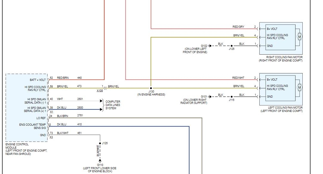

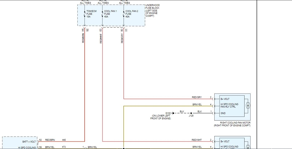

Good evening,
Does the compressor clutch stay engaged as well or just the blower motor and the cooling fan?
The PCM is what controls the cooling fans. Good chance it may need the PCM replaced.
Are there any codes?
