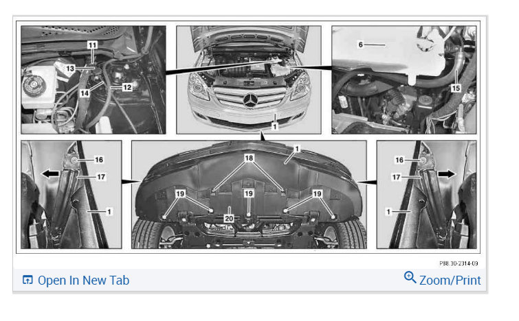

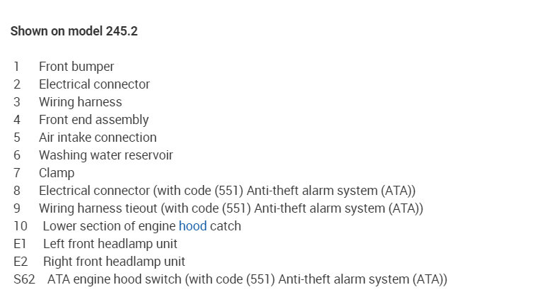

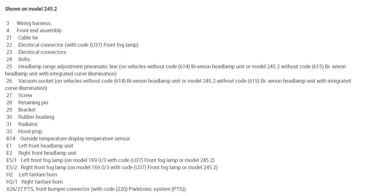

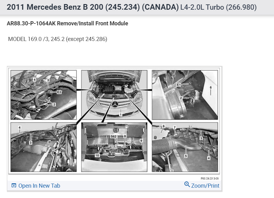

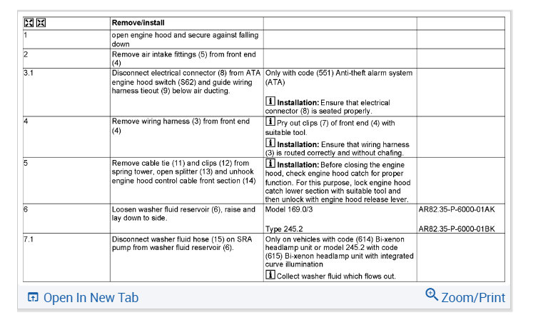

What is the code the CAN scan found? I have seen the front control module go out on these cars which cause all kinds of weird problems. Here is the location and how to change it out in the images below. Check out the diagrams (below). Please let us know what you find. We are interested to see what it is.
