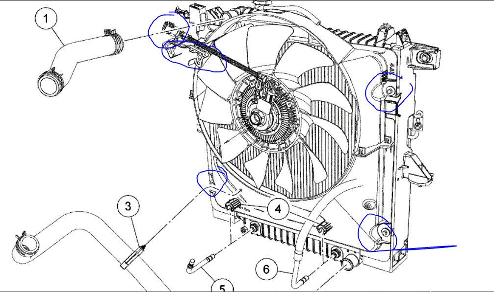

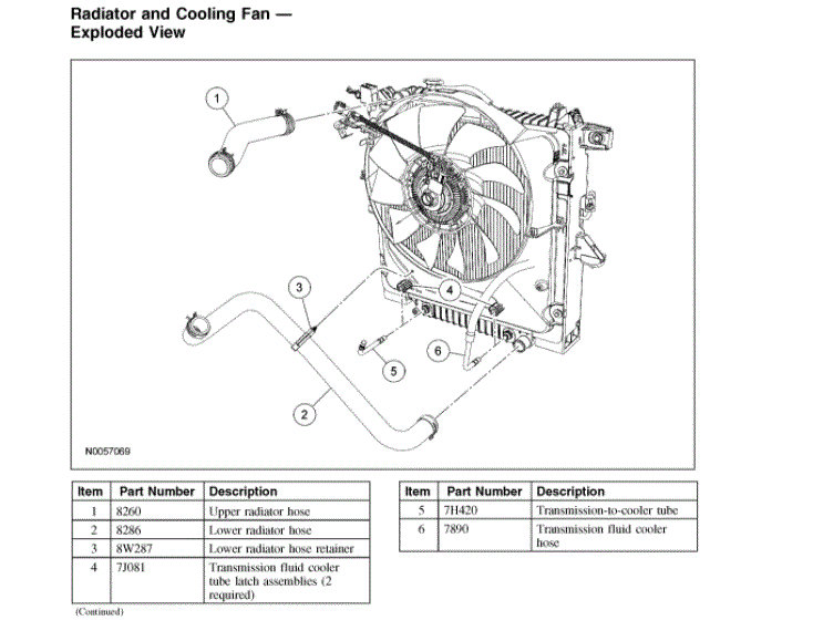

I attached pictures for you of the cooling fan. There are 4 mounting bolts and an electrical connector.
https://www.2carpros.com/articles/replace-electric-fan-motor
