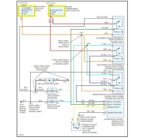

My car keeps overheating due to fans not coming on at all. I need to know if that is normal or if my relays are bad. I know there are three under the hood right next to eacheck other but I don't know which one to change.

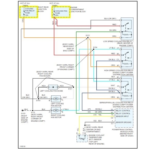

Good morning,
It may or may not be a relay. Testing needs to be done to be sure you have available voltage for the fans to work.
I attached a wire diagram for you to view. Check the fuses with a test light to be sure there is voltage on both sides.
