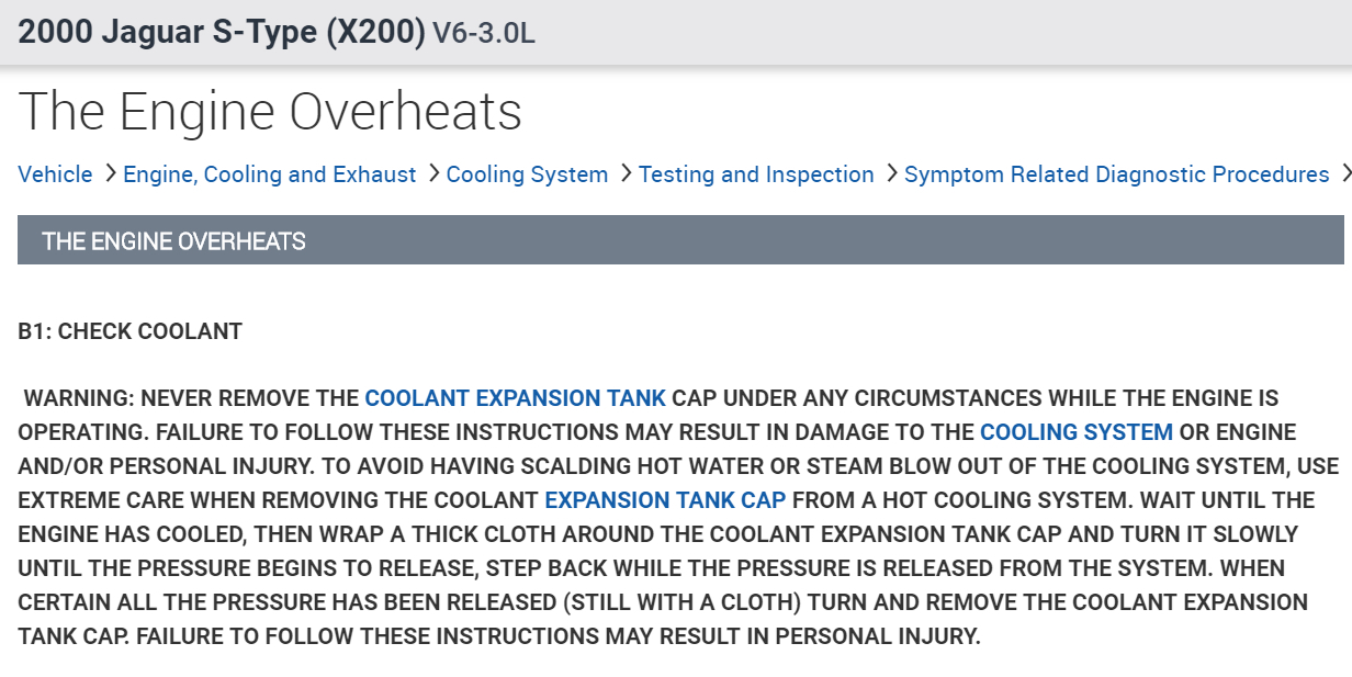

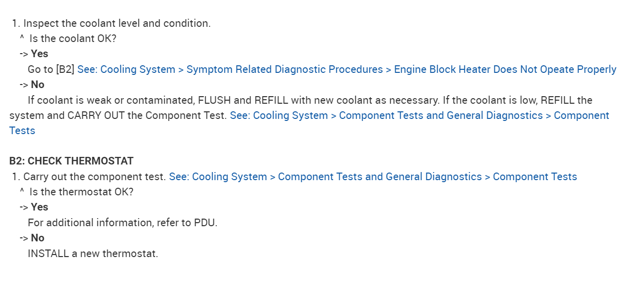

This could be a problem with your thermostat. I have included for you in the diagrams down below a factory troubleshooting flow chart for engine overheating. Please go through it and let us know what you find out.
